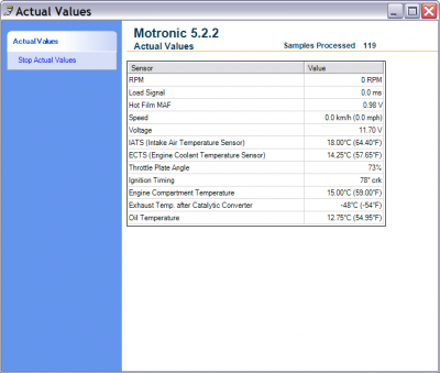

  14. There are many things it could be before your DME (Engine Computer). You should find a shop with some test equipment like the Durametric Software, a PST2, or PIWIS tester and have them look at your air flow (MAF reading). And, as I said check for damage on that one sensor - it is fairly common to have mice (or other rodents) eat away the insulation on wires during storage. We've seen and heard it it here many times.

  17. P1124 Oxygen Sensing Adaptation Area 1 (Cylinders 1 - 3) - Rich Threshold P1126 Oxygen Sensing Adaptation Area 1 (Cylinders 4 - 6) - Rich Threshold This means that your mixture is running too lean - that is, the DME can not make the mixture rich enough to compensate for additional air. Potential fault areas: - Intake air system leaking. - Fuel pressure too low. - Volume supply of fuel pump too low. - Fuel injectors fouled. A really bad MAF reading can cause this as well as intake leaks (cracked oil filler tube, AOS, etc., etc.) P0130 Oxygen Sensor Ahead of Catalytic Converter (Cylinders 1 - 3) - Intercore Short Circuit or Limited Voltage Increase - Oxygen sensor - Wiring harness - DME control module This sensor needs to be checked to see if it is cracked (ceramic) or if the wires are damaged.
