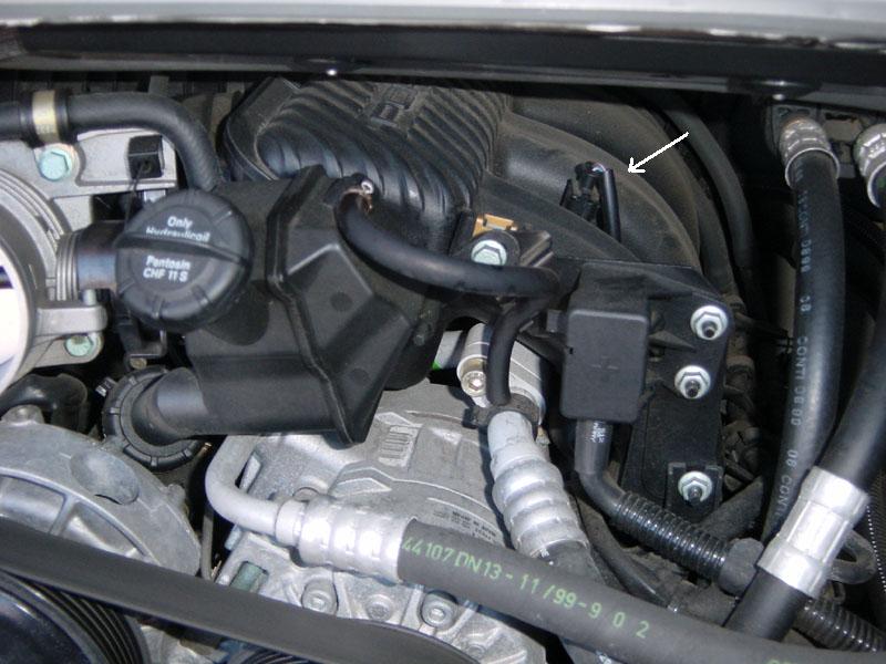

  22. On a US Carrera it looks like this:
