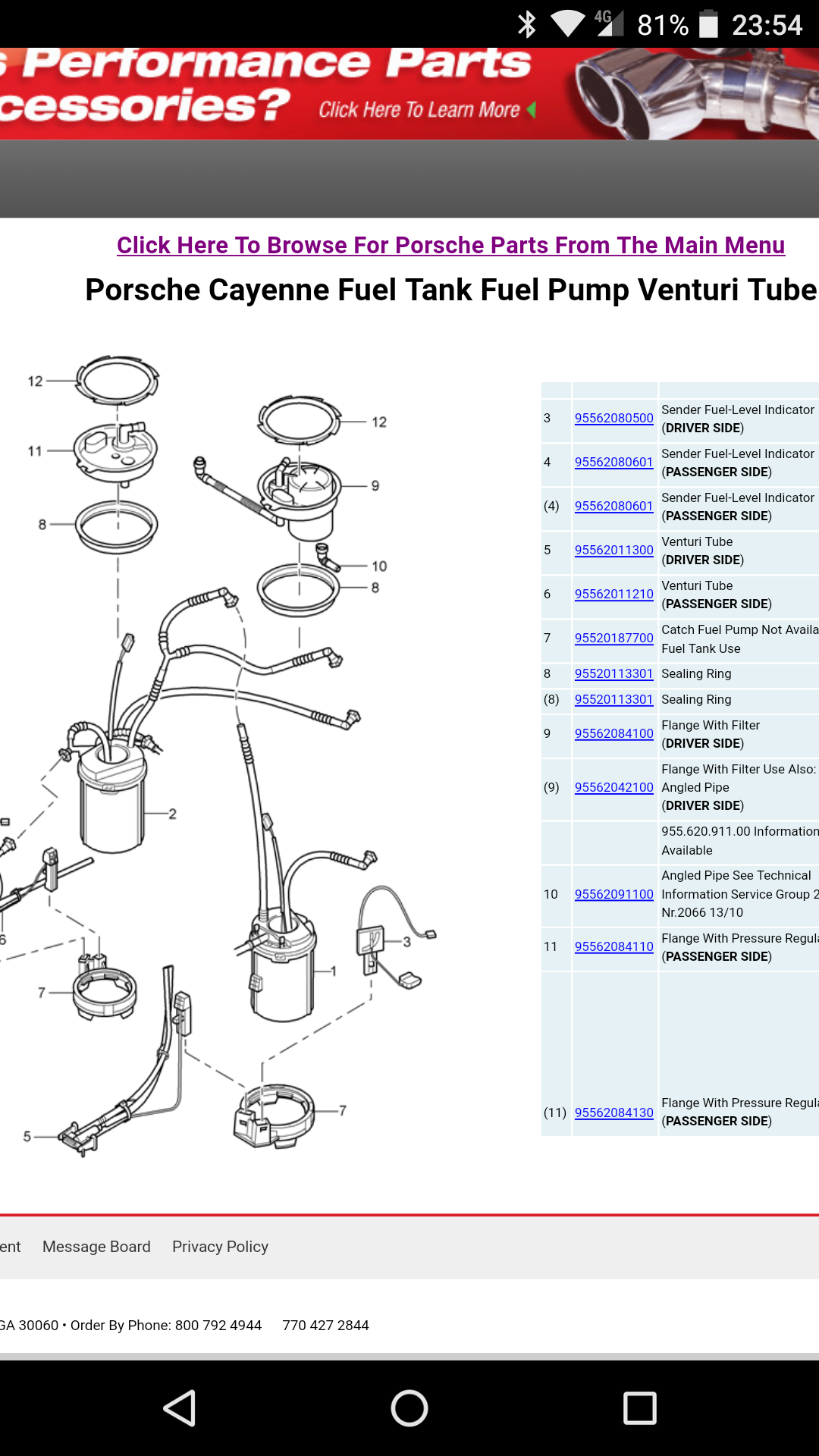

  8. Sounds like this issue only presented itself after the fuel pump was replaced? Open and replace both Rubber gaskets (labelled as seals number 8 on the diagram) on the left and right side filter and regulator respectively, would be my first and most inexpensive thing to try if DIY and no other ideas. The rubbers are very tricky to refit even when new but a helper will make it easier to get it seated properly and not leak. Also the vent pipes to the tank fittings can get damaged by some enthusiastic mechanic work, so consider that as well.
