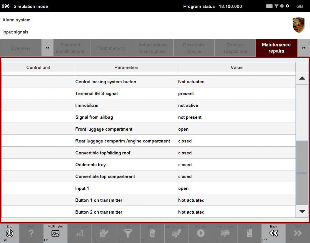

  2. Try looking in the input signals of the alarm control module on PIWIS. These are from PIWIS2 in Simulation Mode. Select Alarm from the Overview screen, then Maintenance repairs, and choose Input Signals.
