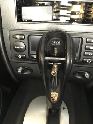

  17. This has been bugging me. The knob (shiny) part popped off one day, with the metal U-ish shape still attached to it. Refer to Pic 1, the U-ish shape metal is marked. Now I have been having no luck in trying to put the knob into the lever again! Tried installing the U-ish metal first by pushing it against the horizontal bar on the lever (Pic 2), however once that's in I have no way putting the metal into the know again. Please help :-(
