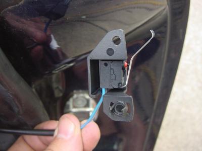

1schoir replied to WeekendWonder's topic in 996 Series (Carrera, Carrera 4, Carrera 4S, Targa)
Just to clarify... The microswitch in the photo is the one behind the outer door handle. You can see the small black part (just above the microswitch metal lever) that acts on the microswitch. As the handle is pulled up from the outside, that small black part "rotates" and presses on the switch. That is what causes the 1/2 inch drop of the window when you initially pull on the outer door handle. There is another similar switch (not shown in the photo) which is mounted on the backside of the door panel and which has a similar effect on the window when the inner door handle is pulled. To locate the remaining switch, follow along the (green in my '97) plastic cable which you see sort of bent over at the left center of the photo. That cable, which is covered by a black fluted rubber cover as it goes forward to where it is connected to the inner door handle, is the cable that acts on the latch which is on the (rearmost) side of the door to unlock the door. You can see where it leads to sort of vertical (slanted) cylinder with wires coming out of the bottom. The remaining switch is in that location, and that is the one that is tripped by either closing/opening the door, or by closing the latch (2 clicks) as Tool Pants suggested above. Regards, Maurice. -

Tool Pants: Here is a good photo of one of the (three ?) microswitches inside the door for your files: Regards, Maurice. -
