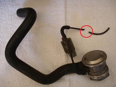

  1. Another time I had the same alarms I found a broken vacuum line between the reservoir and the electric vacuum switching valve.

  3. Glad you found the problem... Was it the hose connection identified in the attached photo?

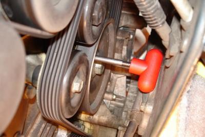

  12. The picture of the red handle locking tool is the one I took when I did my IMS bearing replacement. Yes I did remove the red handle by unscrewing it so I could get the locking pin in-place. I put the handle back on the end just for the picture so you could easily see the tool.

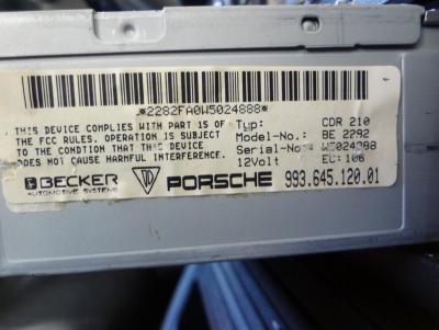

  17. Loren, CDR 210 - W5024888 Thanks Jager
  18. Did you read the procedure to have it display on the radio in the Lost Radio Code FAQ? He had the procedure for the 220 and it made no sense for the 210. We continued the work and disconnected the power knowing we could get to the decal on the side of the radio but as you can see a couple digits are hard to read. If you click on the photo it increases size making it easier to view. I am guessing the number is W5024388 or W5024888. From the Lost Radio Code FAQ... "CR-210: Press tone, then 8 and 0 simultaneously. "Becker" appears. Press station up arrow on right. "PR-VERS" appears. Press one of numbered buttons below display, directly below the LCD arrowheads (try a few). The model number will appear. Press station up arrow on right. "SERIAL N" will appear. Press the numbered button again. The serial number will appear. Or, if the radio is out of the car the then the serial number is on the label." So this works after the power was disconnected... Hmm... So we got W5024888.
  19. Did you read the procedure to have it display on the radio in the Lost Radio Code FAQ? He had the procedure for the 220 and it made no sense for the 210. We continued the work and disconnected the power knowing we could get to the decal on the side of the radio but as you can see a couple digits are hard to read. If you click on the photo it increases size making it easier to view. I am guessing the number is W5024388 or W5024888.
  20. Loren, Hard to read a couple digits on this one (see attached photo). A friends 97 Boxster, we had to remove the alternator and disconnected the battery... Help! Thanks Jager
