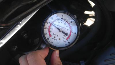

No, I did not. I stopped after the fuel pressure test as the fuel pressure reading was well within spec, and it seemed to me like the pressure would have to be either high (clogged) or low if there was fuel delivery problems, especially given that one bank is running richer than the other where fuel pressure should affect both banks. Weather depending, I might try that this weekend before taking it to the shop. The car is running fine, and it takes a while for the CEL to re-trigger, so I doubt it is a major problem and don't mind driving it a bit while trying to track down the culprit. Thanks for the idea!

As I said, I'd check back in after a while. It took a couple hundred miles, but the check engine light re-triggered. Given the low mileage for the age, I'm inclined to believe it's a clogged injector or a failing O2 sensor. In either case, refurbishing six injectors and/or replacing four O2 sensors without completely identifying the problem is too expensive and too much work for my taste, so I'll take it to my local independent Porsche mechanic sometime shortly and have them properly diagnose the problem. I'll report back then with what they find.

Good to know. I checked soon after to ensure the light illuminates when the ignition is in the on position with the engine off, so I know the bulb didn't burn out. I just wanted to double check that the fault clearing itself is normal. So far I have put 150 miles on the Techron filled tank without the CEL re-triggering. I'll post again if the fault re-triggers and provides any additional information, or if it doesn't re-trigger, in a couple hundred miles with the future FRA and TRA values. Thanks, all!
Much appreciated (same to everyone who has replied). I drove it low on gas today, and the check engine light turned off without me resetting the code. I haven't verified that the code is still present, but is that possible? Or did the bulb burn out? It's not an AUDI so I doubt the light has been illuminated for that long... I did add a bottle of Techron concentrate at less than 1/8th of a tank and filled it to about 3/4th tank. So far, I put 110-130 miles on it and haven't noticed any problems. I will reattach the Durametric when I get a chance, or should the check engine light re-trigger, sooner to get additional information. Thanks again, all.
Since it took 90 miles for the fault to re-trigger last time, and since the car is running rich as opposed to running lean, and since everything else checked out, I will definitely give this a try. Well, that and it's so hot that I really don't want to spend hours in the garage tearing apart a near-perfectly running car... :) Thank you!

Sorry for the delay in replying, but life has been a bit hectic. First, sorry but false alarm about excessive vacuum pressure earlier. When I converted my vacuum readings to BAR, I didn't realize that my vacuum gauge measures in in.Hg for vacuum but PSI for pressure. Thus, I converted BAR from PSI instead of in.Hg. In my defense, I did say I was a newbie in the topic of this thread. :) Attached are pictures from my Actron vacuum gauge with the 996 at operating temperature, as well as a reference image to show the base reading. As you can see, I get about 14 in.Hg (0.474 BAR - for real this time) of vacuum at idle at 680RPM. When the vacuum gauge is T'd into the vacuum line attached to the fuel pressure regulator, the vacuum measured drops to 12 in.Hg (0.406 BAR). That puts it within the 0.4-0.6 BAR specifications from that 986 diagnostic PDF Ahsai provided. Unfortunately, this means it is most likely leaky fuel injector(s). This makes sense, given the fact that one bank is running richer than the other, the low mileage of the car likely meaning it or its gas sat for long periods of time, etc. I'll talk with Reno Rennsport regarding options of having my injectors refurbished/cleaned, but should that be cost prohibitive or the injector be not salvageable, does anyone have any experience with Beck Arnley refurbished fuel injectors? Looking online, it seems like I can replace the whole bank of injectors with them for the price of one new Bosch injector. And since the fuel rail would be removed, I'd prefer to clean or replace all three rather than guess which injector is the problem based on the burn condition from reading the spark plug. Thank you!

Yes, and an incorrect amount of vacuum applied to the fuel pressure regulator would directly affect the amount of fuel being delivered, which is exactly the fault being generated. If there was no or little vacuum, then I would have a leak, and I could check for that. But what can cause excessive vacuum? That said, I T'd into the line going to the fuel pressure regulator as it seemed like I wouldn't want zero vacuum at the fuel pressure regulator. Was that correct? Or is it safe and was I supposed to take the fuel pressure regulator out of the equation entirely and just measure the vacuum on the line? If it is safe to run the car at idle with the fuel pressure regulator's line detached, and if the excessive vacuum pressure is reproduced with the warm motor, then I would to see if there is a difference with the fuel pressure regulator applied. If so, then maybe the problem is with the fuel pressure regulator...?
