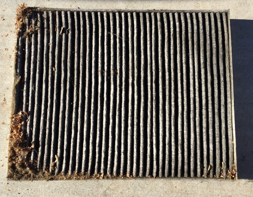

  17. problem solved and lesson learned. cabin filters can be as important as the respirators for the crew of eight under the hood, and might need as frequent attention:) Wonder why nobody came up with a suggestion, and searching by keywords for air condition smell does not yield any results. However, Just clening out makes a big difference. new one on the way....
  18. Hi - on my 06 CTTS, over the last few months I noticed occasionally awful smell inside the cabin while driving. My research so far indicates that it is emitted from vents when AC system is on. Believe it smells like sth. burned, and is not present when I switch AC system completely off. Did anybody experience this before on a 955 Cayenne, Turbo or Turbo S ? Thanks in advance. PS.: side note. It may be coincidence or completely unrelated, but as far as electrical problems I am noticing for about comparable amount of time that the horn is dead (silence when pressing the steering wheel center...).
