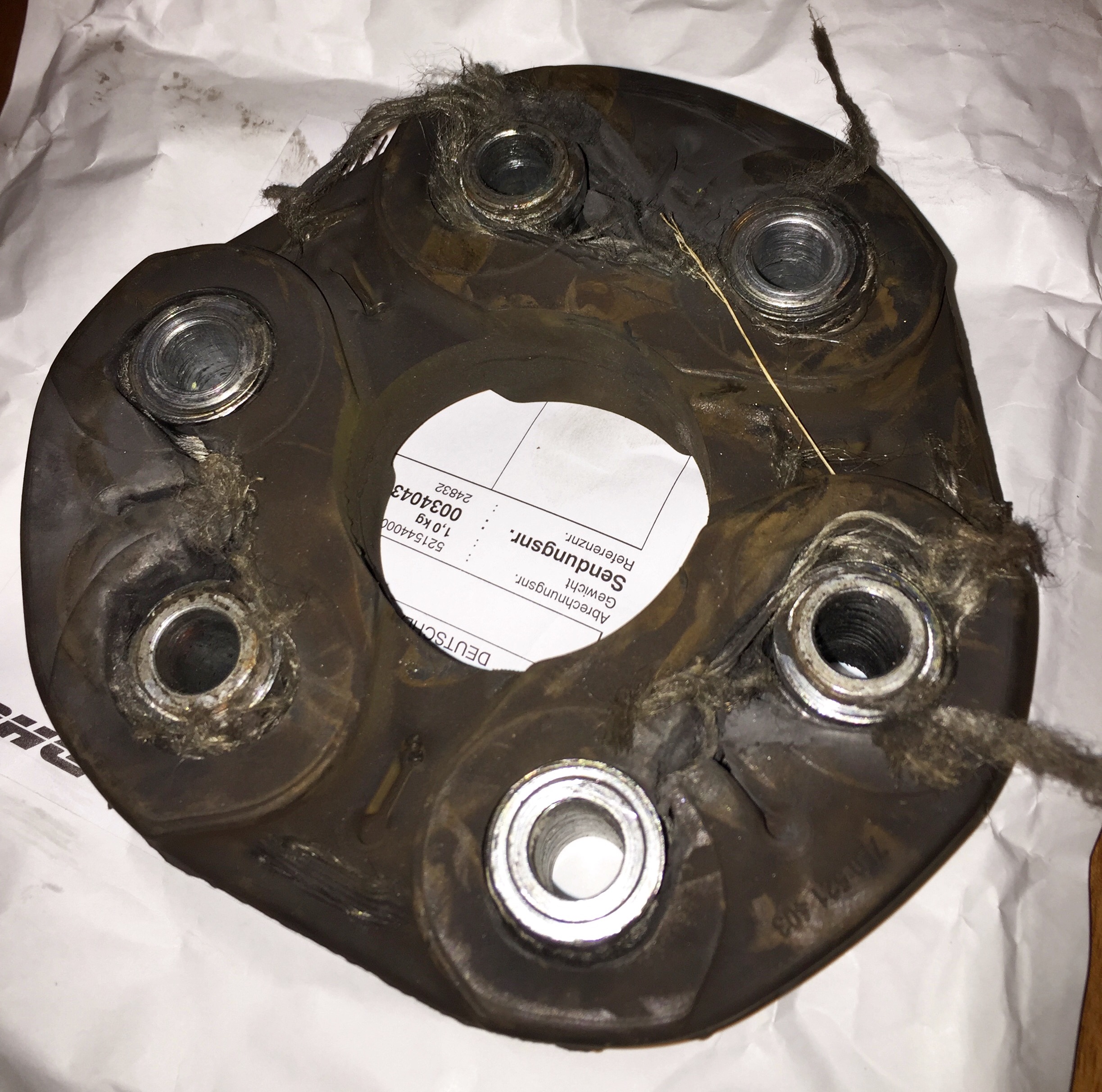

  18. Just took my car from the shop. Take it there because i had vibration and was thinking the new cardan shaft from last year could be the reason. It was only the flex disc. Thanks god. Drove now 25 km home. Feels good. I will bite my *** if all my searching in the engine compartment looking for the vibration was not the engine, was the cardan. We will see
  19. I got my car back. I was told by my shop the cardsn shaft is ok, the flex disc was destroyed.

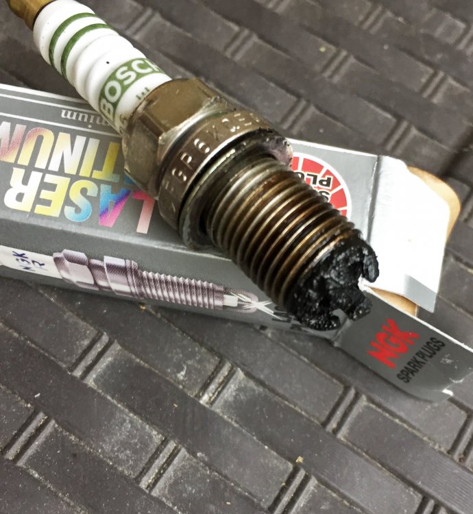

  20. This is how the plug from the damaged cylinder looks like after several hundred kilometers.
