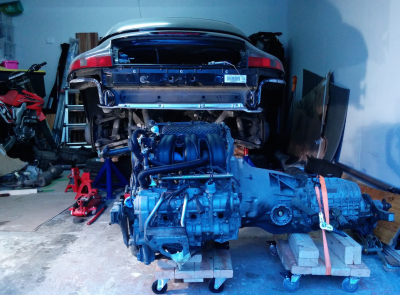

  7. If you use jack stands, please make absolutely sure they are safe even if something rocks the car (even a small earthquake on California). I made rock solid jack stands the cheap way, see my posting here http://www.renntech.org/forums/topic/46241-create-rock-solid-jack-stands-for-your-porsche/ Also, my garage is less than 19' long and I've managed to pull my 996 engine + transmission twice. However I fabricated two trolleys from 2x4 and strong castors and I could steer the whole package out in two axis.

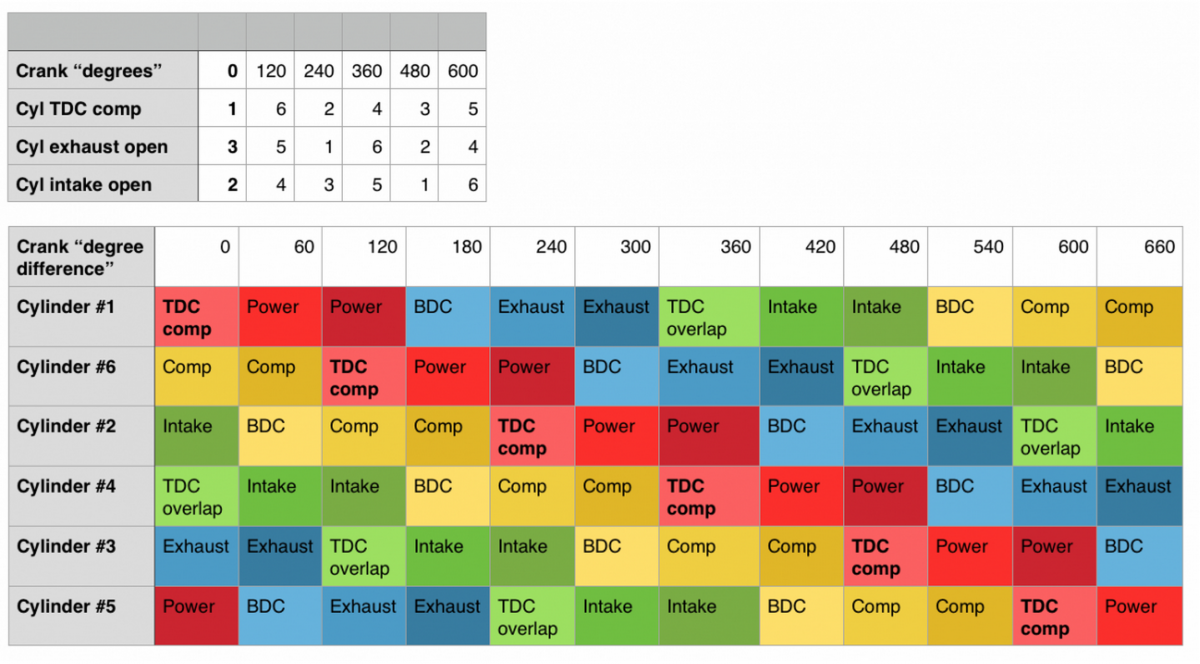

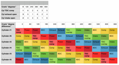

  13. Here's a rough draft regarding cylinder stages that I did during my IMS / .. maintenance:
  14. To my understanding this cannot be true, there's always load in either bank 1 or 2 when you put locking pin to crank pulley (TDC Zyl #1) you are either 1) TDC compression #1 meaning - Cyl #1 TDC compression, has no valves open - Cyl #6 compression stage, all valves closed - Cyl #2 intake stage, has intake valves open (STRESS on bank 1) - Cyl #4 TDC overlap, no valves open (under overlap) - Cyl #3 exhaust stage, has exhaust valves open (STRESS on bank 1) - Cyl #5 power stage, all valves closed or 2) TDC overlap for Cyl #1 meaning - Cyl #1 TDC overlap, no valves open (under overlap) - Cyl #6 exhaust stage, has exhaust valves open (STRESS on bank 2) - Cyl #2 power stage, all valves closed - Cyl #4 TDC compression, has no valves open - Cyl #3 compression stage, all valves closed - Cyl #5 intake stage, has intake valves open (STRESS on bank 2) I have personally turned crank multiple times and observed how valves move on each cylinder.
