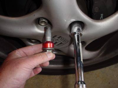

Today I have been mounting spacers. Impossible for me unscrew little screws on hub. I have installed spacers with no screw, but with 130Nm on longer bolts. I just hope no problem. What do you think?
The little screws are more for convenience...they hold the spacer to the rotor/hub. They keep the spacer in place when mounting the wheel and when removing the wheel. If you don't use the screws, then the spacer may stick to the back of the wheel or simply fall. If the spacer falls into the wheel, it could scratch or otherwise damage it. The lug bolts hold the wheel, spacer, and rotor firmly to the hub. --Brian
Edited by Q-Ship986
Then I can do without screw with no problem (unless removing a wheel).... thanks Qship, now I am in calm.

A 5 mm spacer is not much, less than 1/4 of an inch.
Local owner Henry put 996 wheels on his 2000 2.7 and used 6 mm spacers with the original 45 mm wheel bolts for 10,000 miles. He is still alive as is his Boxster. After I teased him long enough he put on the 50 mm GT3 wheel bolts.
I wish I had counted the number of turns he had before and after the wheel bolt change. Next time I see Henry I might just do that.
There is a rule of thumb for the number of turns when using spacers and the stock wheel bolts. I have have seen different rules.
On my 1997 with stock 17" wheels and stock wheel bolts with no spacers I counted 7.5 turns for the front.

The reason for a minimum thread engagement is to protect people from the threads stripping from the hubs, period. Here's how it works. There is a certain amount of tension on the head of the bolt holding the wheel to the hub. The force at the head is countered by the threads holding the bolt in the hubs. Each turn of thread supports a proportional amount of this force. Half the number of engaged threads and the force on each thread doubles. The local stress in the hub near the face contacting the wheel increases because the load is not as evely spread out along the depth of the thread so the total risk of thread stripping is even greater than double.
When the engineers defined the attachment of the wheels, they chose a bolt material, a hub material, a thread pitch and size and bolt length all designed for an acceptable factor of safety to protect from the head of the bolt snapping and/or the threads stripping considering the weakest possible bolt, the sloppiest possible threads and the most possible force on the bolts (lots of torque + some lateral load on the tires). This factor of safetly is typically 2.5-3.0 in this application although I don't know specifically what Porsche uses.
When you decrease the number of engaged threads you cut into this safetly margin, possibly significantly. Because there is a nice large margin, you would probably be fine with shorter threads, but my question is why take the risk?
