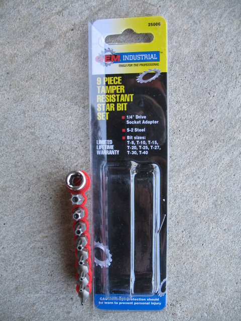

Orchard Supply (I think only in California) and some Ace Hardware store sell individual anti-tamper torx bits for about $2.
Autozone has a set for $10. I have also seen sets at other auto supply places. Might as well buy the set as you may need other sizes for other things.

Anyplace in particular to find the T20H bit? I haven't noticed them in my local hardware store.
I got mine in a kit I bought from Frys Electronics (US west coast only, I believe). Places like Home Depot don't carry it. My kit is a full kit of virtually every type of common security bit available - I think it cost me around $30, which is pretty cheap considering it has so many specialist bits.
