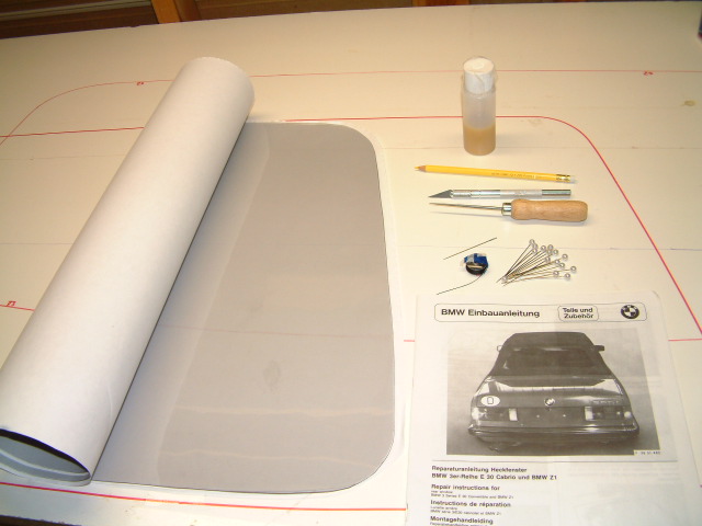

3. eBay has DIY soft top rear window kits that you sew in yourself. ~$100 for these. i've never seen a boxster top with one of these windows, but i can't imagine it looks too good. but, i may be wrong. ;)

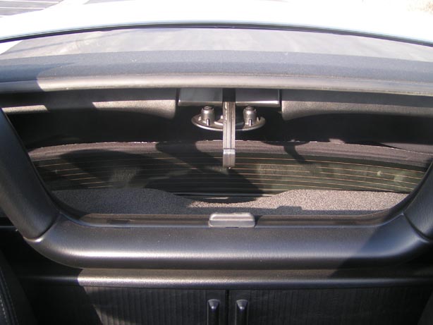

I haven't had it done yet but I did speak with my boat canvas guy last week. He didn't even cough at the request since I explained you can unhook the rear of the window assembly (engine maintance mode). He said if he hand sews it in he can do the over/under sticking with that type of access. He claims some convertible designers are far harder. He also is quoting me about $200 for marine grade isenglass. Why so cheap? Becuase I live in the midwest in rural Ohio!

There was a guy on ebay selling a plastic window kit for various cars such as Miata, Z3, and the Boxster. Have not seen it on ebay for a while.
In my area we have a plastic stuff chain store called TAP Plastics. They sell the window stuff by the foot. A guy on Pelican hand sewed in a new window. The stiches looked a little rough, but it was temp fix.

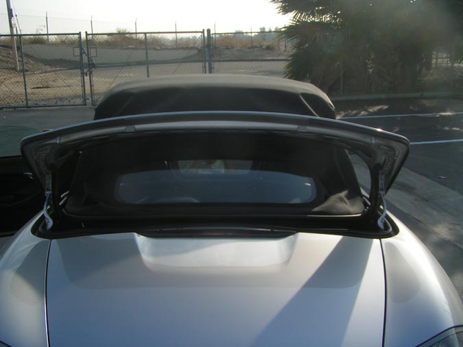

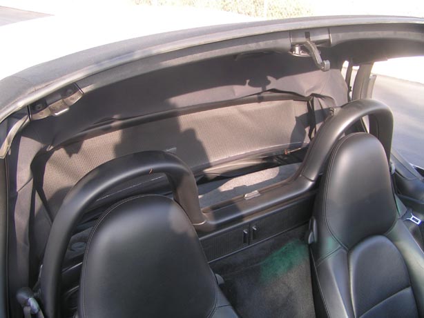

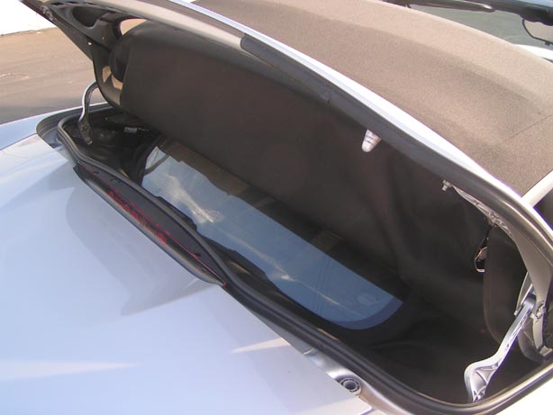

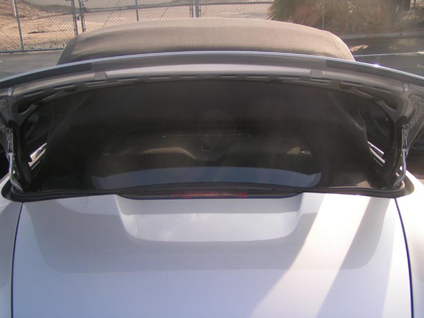

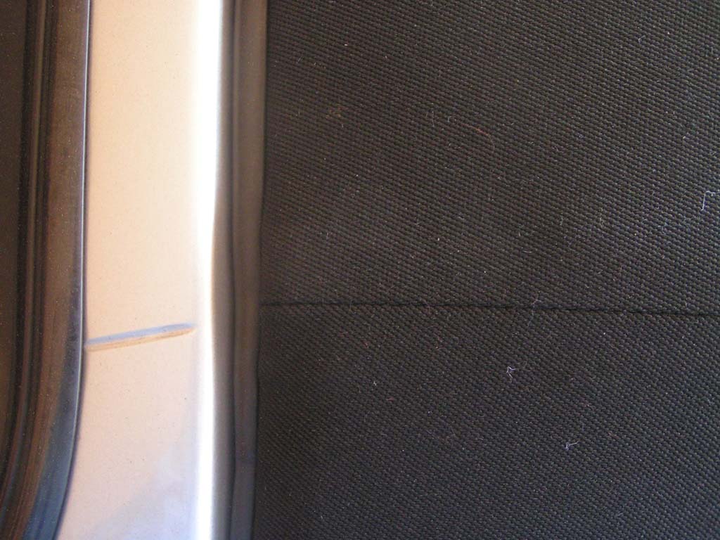

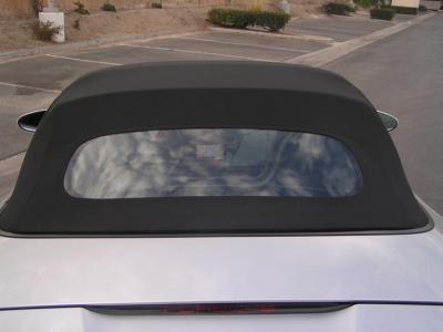

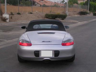

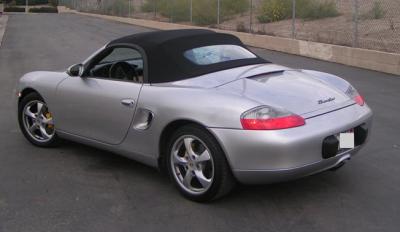

Thanks a LOT for the additional pictures. The fabric looks like stock to me. The crease around the window does look a little strange, but it's probably due to the way it has to fold. One thing that looks different than the GAHH and BAS is the molding around the window. The Robbins is flat fabric. The GAHH has plastic molding that sticks out a fair amount and looks like it will collect dirt. The BAS has a thick rubber surround. The defroster lines look good. It seems the window molding is the tell-tale way to determine which of the 3 tops I'm looking at when I see one in real life or try to determine who is selling what.
