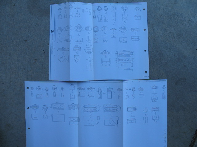

I have never played with the DME connectors, like you have. On other style Amp connectors I was able to decode them enough to buy them from BMW or Mercedes or VW. Are there any VW/Audi/Mercedes/BMW logos on the connectors?
At the end of one of my wiring diagrams is a list of all the connectors used in the car. There are numbers above each connector but they look nothing like a part number. The pictures are a sample.
Years ago Peter Smith showed me an electrical repair kit at the dealership. This kit also had a diagram of the connectors. There must be a way of buying just the connector, rather than buying a wiring harness just to get the connector. But I do not know how. I would have to ask Peter to see if he knows how.
