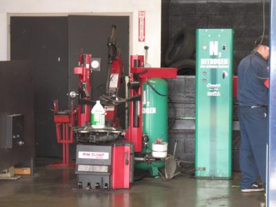

Many local tires store do the nitrogen flush & fill for about $20. That's about one week's allowance for Starbucks!.
Costco fills all new tires with nitrogen.
