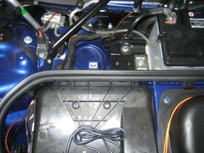

Loren and Fads,
Thanks for input! Still having the problem finding the two screws to release the cannister. I took some pics to hopefully make it a little clearer.

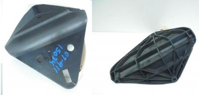

I am trying to remove my canister as well.  The parts diagram does not help though.  It is from a 2 wheel drive and the 4's are different.
Share this post
The only thing that should be different (according to the Porsche parts list) is vent line (item 2 on the bottom) and the support on top is slightly different but attaches the same way.
The outer lid lid design changed but again is functionally the same.
The photos above the diagram are from a C4S.
Share this post
I see the photos above and that is exactly how my car looks.  The top of the bracket where the screw is shown on the parts diagram is behind the unit.  The bracket on the 4's turns down not up.  Therefore there is no head of a screw that is exposed that I can see.  If you look on the other side of the wall there is a screw that I removed, but it did not release the bracket.
