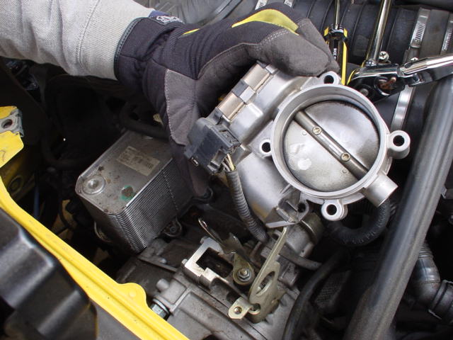

Thanks for your help Loren; I removed the large air duct that runs from the air cleaner box to the throttle body. I couldn't get to the bolts on the bottom to completely remove the body but was able to clean by spaying carb cleaner into it while the body was still on the engine. It cleared the problem and now she idles at a nice 650 rpms!
By the way is there a trick to getting the airline back on the throttle body? I finally got it back on but it was really tough. I greased the lip of the throttle body and then had to heat the duct with a heat gun, keeping it well away from the engine due to gas vapors and it finally set in. There has to be a better way.

:clapping: I thought so.
Both the throttle body and tube should be clean and free from dirt or grease (grease attracts dirt).
I usually just put both hands around it and move it back and forth until I get one (barely) side started - then push straight on.

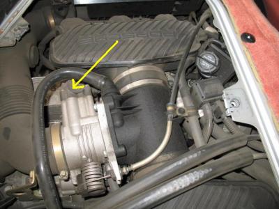

Daryl80. In a prior post you said you have a 1997. Yellow arrow is to the idle control valve on my 1997. It is held in place to the throttle body with 2 bolts.
I have not tried to do this on a Boxster whith the throttle body still connected. So give it a try and see if it works.
Remove the 2 screws and the valve if there is room to do it this way. There is a round thing inside that is supposed to rotate. That thing stabilizes the idle. When carbon gets on it it does not rotate smoothly. Clean it.

Hi Tool Pants
Thanks for your reply and picture. Firstly compared to mine, your engine is spotless!
But yes correct I do have a 1997. I've taken your photo, so can I confirm a few things. Can you please confirm that the item circled in red is the throttle body. Is that correct? In regards to the idle control valve, do I need to remove the tubes as marked in green, to get to it?
To be honest, I thought I had to remove the pipe that comes from the airbox into the throttle body and was expecting to need to get into the butterfly valve. Is this not needed for a 97 Boxster?
Thanks again. I'll give it a go with the two bolts, but please to everyone else, keen to hear if you have any more advice.

The red oval is the throttle body. 1997-1999 is non-egas. You can see the throttle cable in the picture.
I was trying to keep it simple if there is room to remove just the idle valve from throttle body. Have not tried to do it this way on a Boxster, but it can be done this way on a non-egas 996. To clean inside the throttle body itself you need to remove the large tube that comes from the air box.
