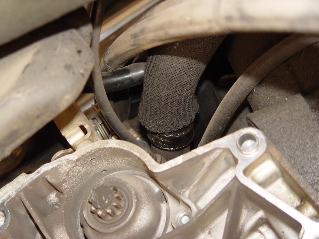

I’m in the process of fixing some oil leaks on a 98 Boxster with a 2.5L engine (84K miles) and thought the following pictures would be of interest to others with leaky engines.
The first picture is the classic “nose drip” under the car.

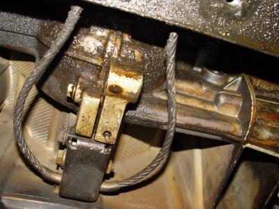

The second picture shows the major sources of the leaks. The intermediate shaft area seems to be the most significant in the clutch housing and the RMS looks much better than I expected. The major cause of the oil leaks is the AOS as can be seen on the right side of the picture.
The third picture shows a close-up of the intermediate shaft area.
The forth picture shows a close-up of the bellows of the AOS and you can see a LARGE hole on the left side of the bellows. I also noticed in the picture what looks like tape that was used to cover the hole. I'll get a closer look what looks like tape when I remove the AOS this weekend.
The last picture shows some seepage from the oil filler hose.

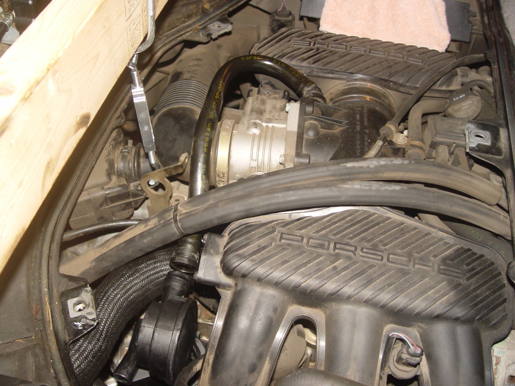

I just finished changing the AOS and filler tube. Having the transmission out of the way made these changes easier. The back side of the bellows on the AOS was almost completely gone. I'll post some pictures tomorrow.
The following images are of the original AOS I replaced. The backside of the bellows (toward the front of the car) was gone. This could have been worsened when removing the AOS.
This is a close-up of the bellows and you can see the significant deterioration of the rubber on the inside of the bellows. My guess on the cause would be a combination of chemical reaction at elevated temperatures.

The following are some thoughts on this project. There is much information in this and other sites as well as the Bentley manual and these are only some additional thoughts on the procedures. These apply to my 98 Boxster.
I did the work myself and put the car on jack stands. I used a motorcycle/ATV jack to remove the muffler and transmission – this made the effort much easier. If I tried to remove the transmission without the jack, I would probably still be under the car with the transmission on top of me while my wife was trying to figure out how to get the mess cleaned up. Following is a picture of this jack. I will make a shorter handle next time I use it as the long handle would hit the bumper and moving the jack further under the car caused the lift to rise.
I used a 2x4 on blocks to support the engine as shown in the following picture and I don’t think I would recommend this approach. I hope someone has a better solution. The hardware results in the load pivot point being under the 2x4 so it would not flip over and a chain wrapped over a 2x4 would give me serious concern of this happening. The hardware also bent from the load as you can see in the picture and even though I adjusted it once, the engine was about ¼ to ½ inch lower when I reinstalled the transmission (based on transmission mounts). I also spent a significant amount of time thinking about what would happen if the 2x4 broke when I was under the car.
I used a slightly different approach then shown in the Bentley manual to remove the muffler. The muffler was supported by the jack shown above. I removed the muffler by sliding the connectors (after loosening the bolts) out of the way at the cats as shown in the following picture. I then unbolted the muffler at the transmission mount. These bolts are easier to get at than the muffler support frame on top of the muffler. These bolts will slide back, but will be stopped by the muffler. The small support frame at the end of the transmission will come down (probably fall at some point) with the muffler. You have to pivot the muffler to get it down as the U shaped section attached to the end make the whole unit too wide to drop straight down. Reinstalling the muffler at these connections was also easy.

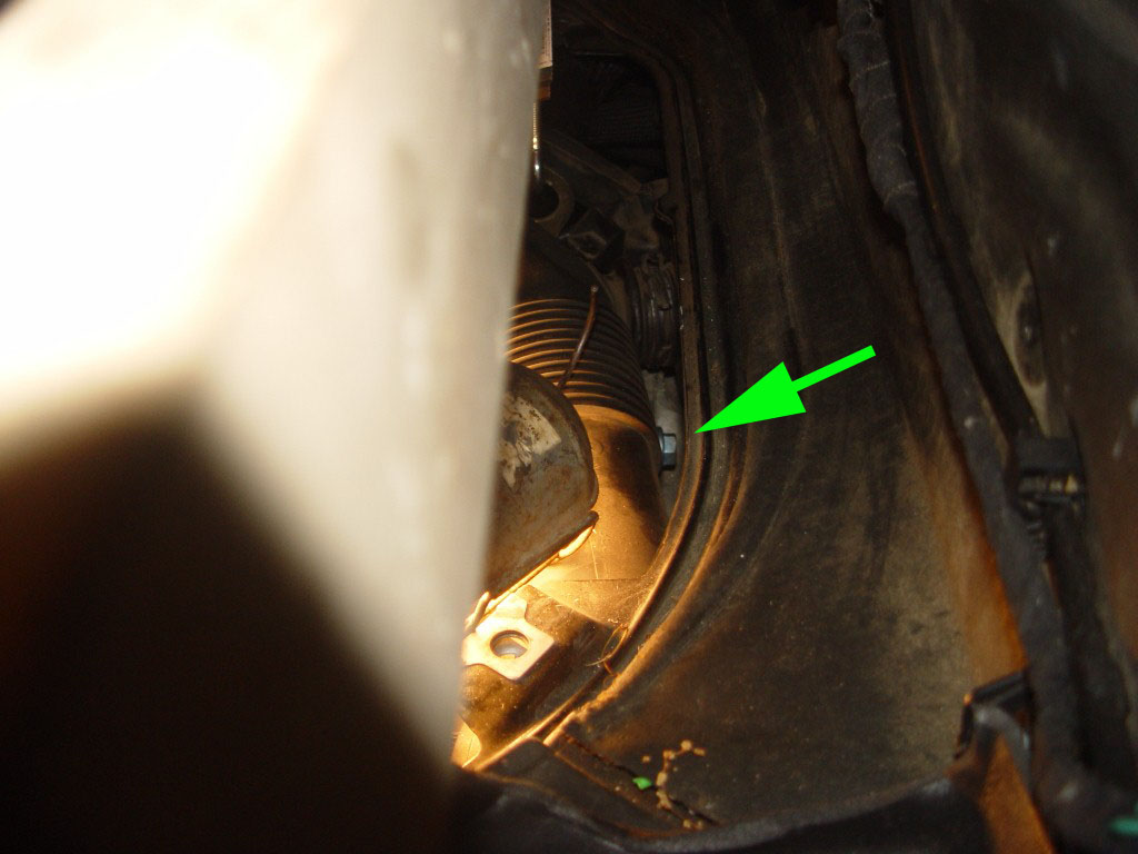

I got a chance to look at the AOS connection this morning. I found that I could see it from the back right corner of the car and following is a picture I took of the AOS connection at the side of the crankcase.
