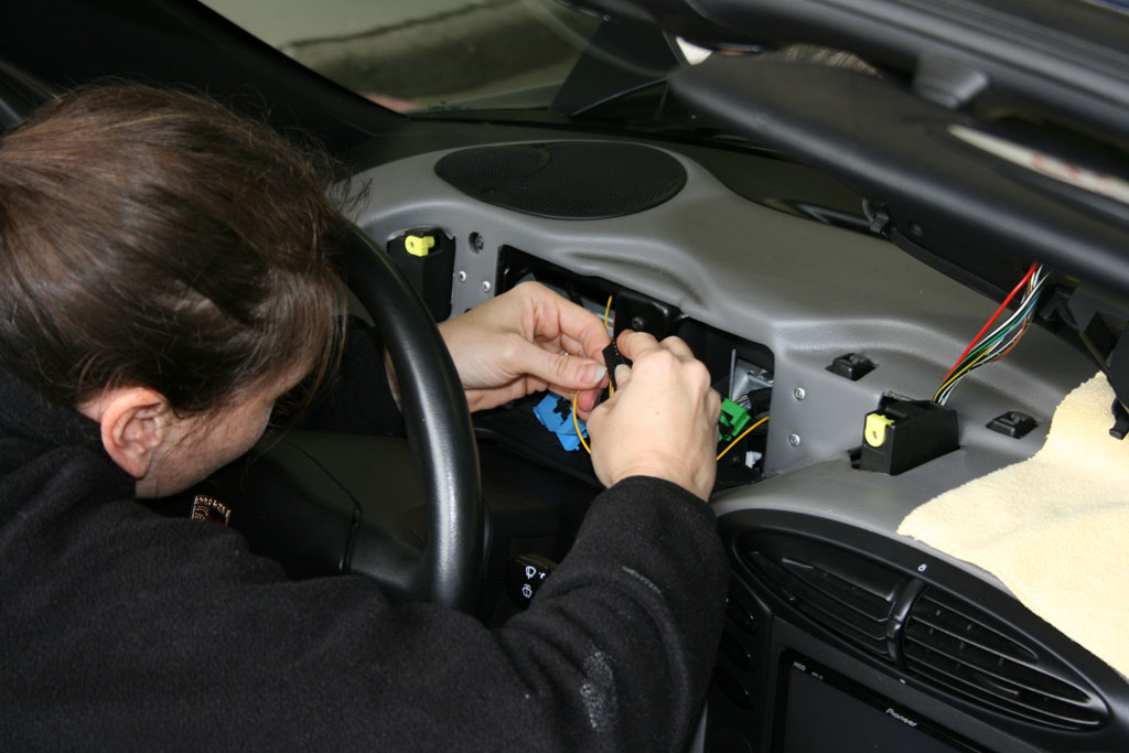

Back to that cluster... (installing a 996 cluster in a Boxster)

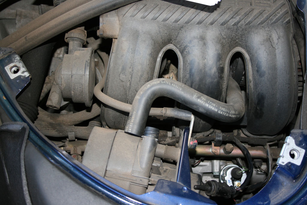

Adding one wire from the cluster to the engine compartment oil pressure sending unit
Where the new (996) sending unit goes...

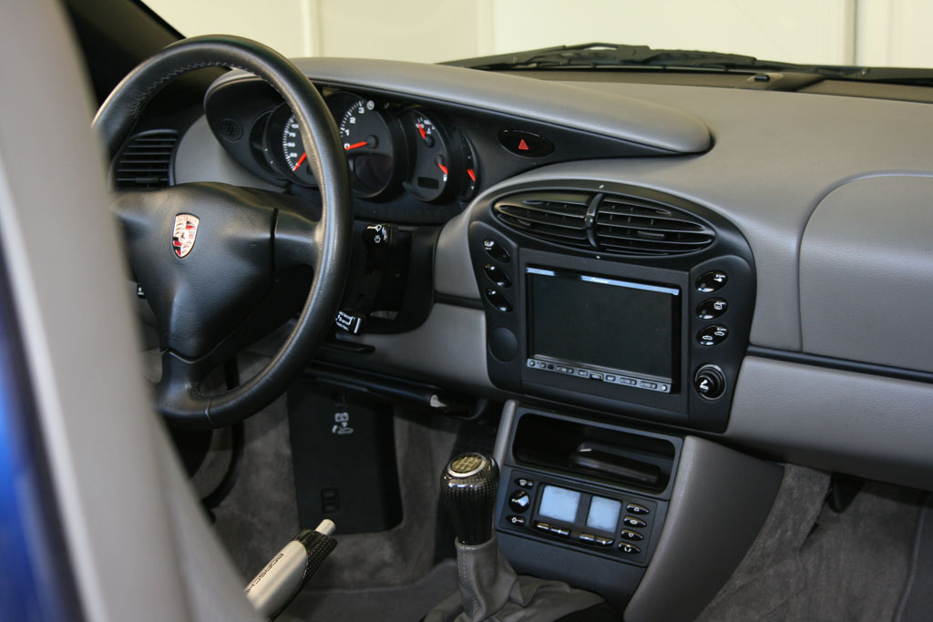

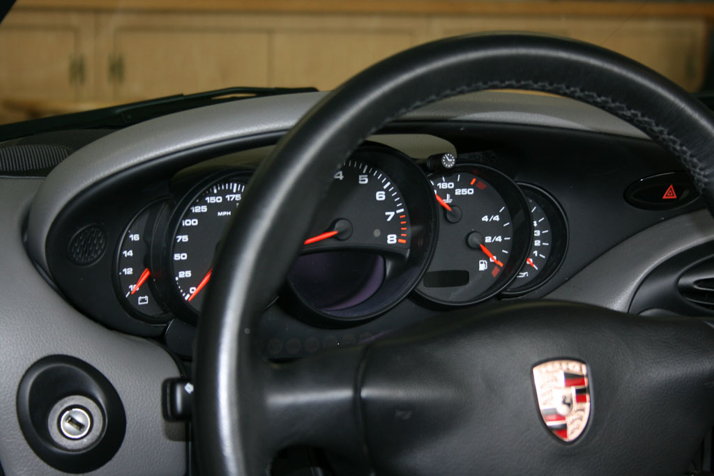

MY2001 Boxster with a fully functional 996 cluster and a B&M short shifter.
