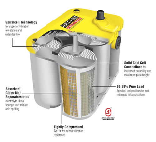

Of course Optima would be the best! Thanks to exclusive SpiralCell Technology, Optima Batteries last twice as long as conventional automotive batteries.

Concerning the Optima batteries, the one thing to watch out for in these Optima batteries is that you DO NOT run it down completely. If you do, these batteries DO NOT recover. I've had two friends who put them in their cars, one in a Corvette and another in a 912. They let the car sat and could not start it after a couple of months and the battery would not charge. Both had the batteries replaced and it happened again after a few months.
Otherwise, they're nice batteries ... a tad bit expensive though.

what u've described applies to any battery out there ,not only the Optima.
once battery is drained like that all the way they r almost not recoverable unless it is deep cycle.

Completely discharging any lead-acid battery will reduce it's life expectancy, Optima or otherwise.
That said, I've got an Optima red top that's over 15 years old that sits in a summer car. It's been fully discharged at least three times and the battery continues to recover and function magnificently.
http://www.1st-optima-batteries.com/
The thing to know with an Optima battery is that only the 34R red top works in our cars without extending the battery cables because of the post locations.
