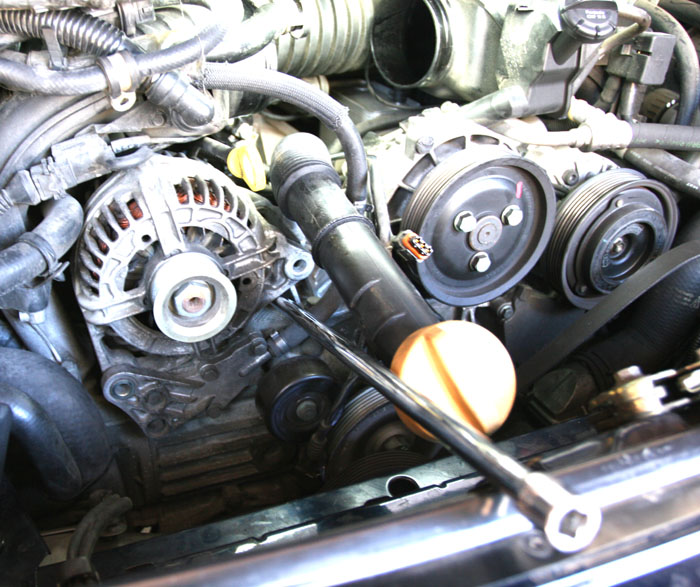

6/7: For the starter mounting bolts I was able to use just a single 2ft extension. The lower bolt looks tricky, but is easily accessible from underneath the alternator mounting bracket. I loosened the main belt and removed the alternator belt tensioner to insert the extension, then attached the socket. You MIGHT be able to get away with several smaller extensions.

Broke down and did the deed today. Thanks for the help gentlemen. Not nearly as daunting as I had feared. A couple of comments. The 2ft extension and the universal joint are the HOT TICKET! Allows for access to both starter mounting bolts with relative ease.
