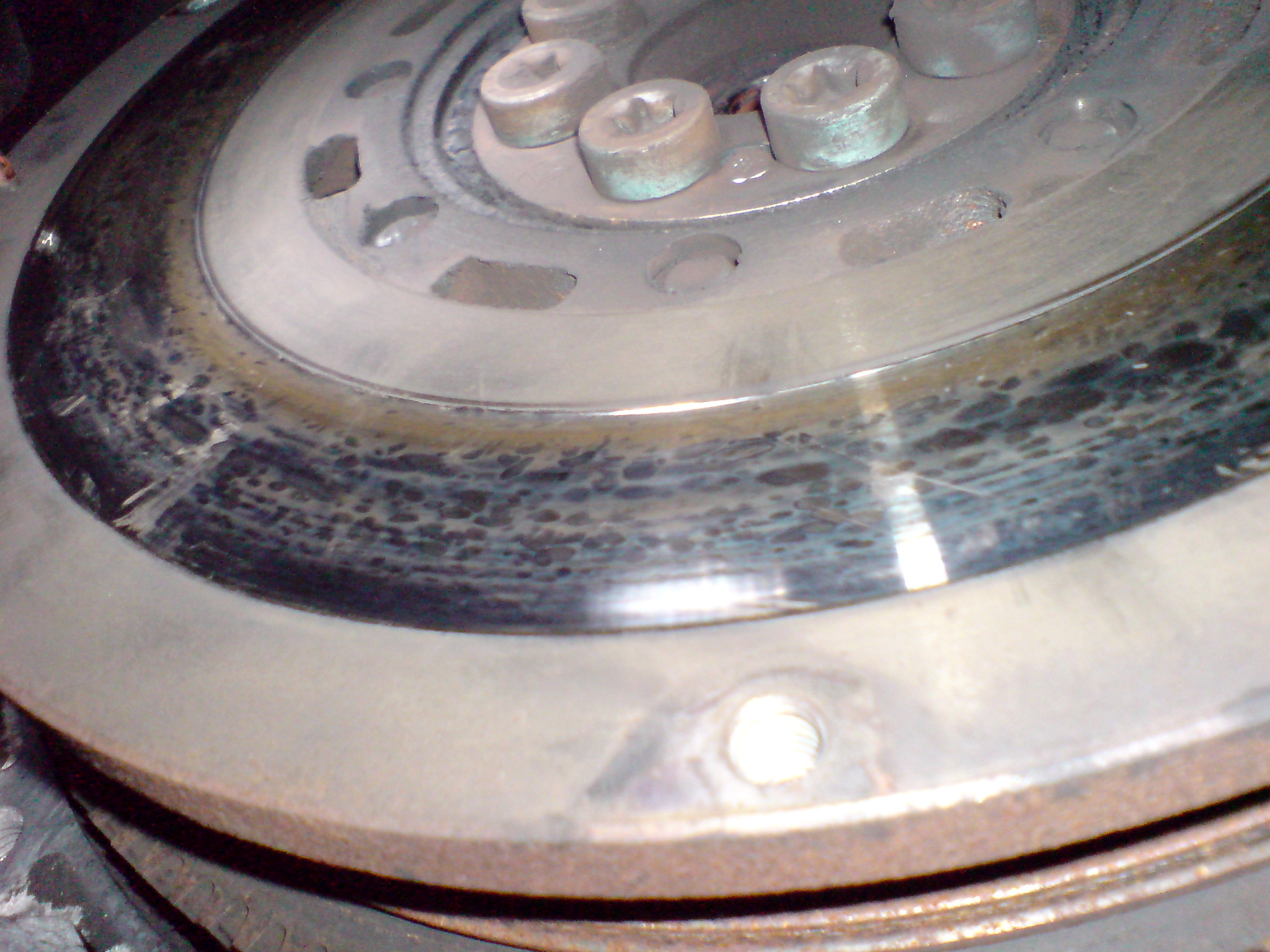

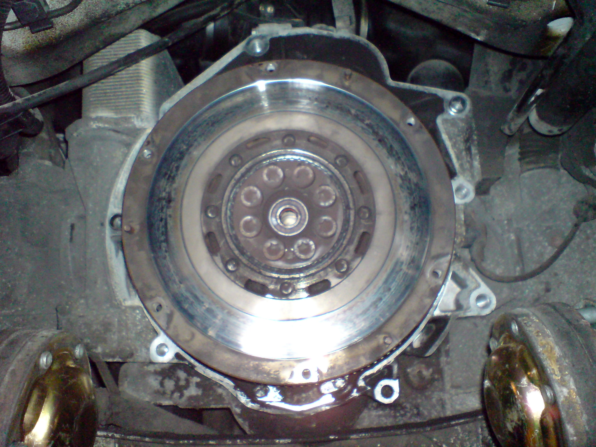

I followed the TSB instructions to check for free play in DMF and its fine. I've taken some pics of the DMF

more pics of the DMF, does this count as excessive scorching of the surface?

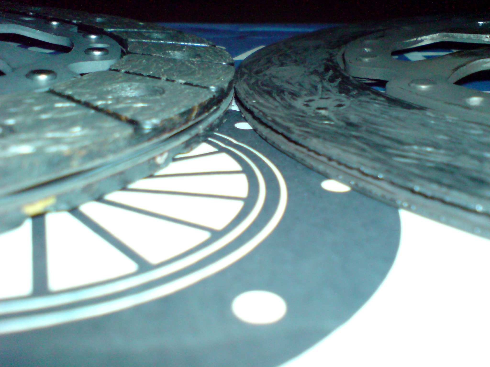

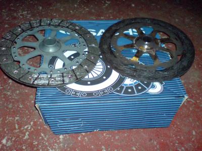

pics of the old clutch and new clutch discs

I'll check it on the bell housing in a couple of hours. How does my DMF look from the pics I posted? Does that count as sufficient scorching to justify a replacement?

Unless the rivets from the clutch disk (were worn through) and scratch up the flywheel or there are groves in the flywheel I would not change it. The scorching looks ok...
