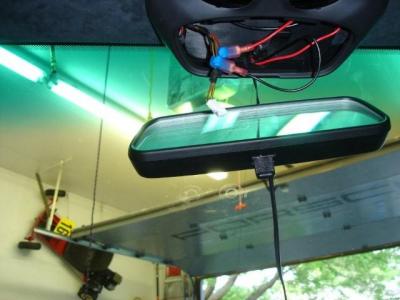

Update to Post DIY: V1 Switched Power Hardwire Installation, V1 Switched Power Hardwire Installation BY: 1080iAddict http://www.renntech.org/forums/index.php?s...l=valentine+one Here are the changes that I found on my 996 (without auto-dimming mirror option) from the 997 in the post listed above. Postive Lead is Red/Black Stripe Negative Lead is Brown This install is non-switched, so you will have to turn off your device manually. Enjoy, Andrew

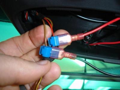

You can also run the wire across the headliner and down the A piler. You can use a credit card or video store card to help tuck the wire in. Then you can continue to tuck it in along the dash and down the side by the weatherstrip. Run the cable under the dash. Then remove the side panel to the radio. The leather one is removed by pulling at the back side first. Then remove the carpet panel. Pull at the back end first. Now reach in and find the phone harness. Attach the black V1 wire to the brown wire using one of these.
Then attach the red V1 wire to the Green/Black for switched power or the Red/Green for unswitched.

You can also run the wire across the headliner and down the A pillar. You can use a credit card or video store card to help tuck the wire in. Then you can continue to tuck it in along the dash and down the side by the weatherstrip. Run the cable under the dash. Then remove the side panel to the radio. The leather one is removed by pulling at the back side first. Then remove the carpet panel. Pull at the back end first. Now reach in and find the phone harness. Attach the black V1 wire to the brown wire using one of these.
Then attach the red V1 wire to the Green/Black for switched power or the Red/Green for unswitched.Good luck,Eric
Enjoy,
Andrew

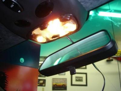

I did the same for my Pro RX65 and it worked well. Also, the power lead is switched if you lock the vehicle with the remote and will power up as soon as you hit the unlock button on the remote.

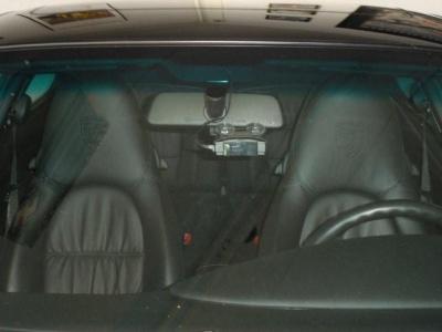

I followed these instructions and installed an Escort Passport 8500 X50 onto the non-auto-dim mirror of my 2001 Porsche 911 (996).
It works perfectly and it is switched. in that it turns off when car is locked and on when car is unlocked. If car is left unlocked "If the ignition key is removed, loads which are switched on or in standby (e.g. power windows, luggage compartment lighting, interior light, radio) are automatically switched off after approximately 2 hours."
