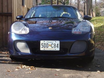

Here is the C4s/Turbo look on a NB

I know that. I am just wondering if anyone has put one of these bumpers on without the side skirts and if it looks awkward or not? The picture above looks nice but it is a facelift car and I do not know how that bumper or others would look with my headlights. All of the sites that sell the bumpers only have pictures of the bumper not on the car or just a front shot of the car which doesnt give me an idea of how it flows with the rest of the car.

Maybe I'm retarded, but those look like the 996 headlights to me.
You can't use your headlights with a TT/GT2 bumper or a MY02 or later GT3 bumper - without changing the front fenders also.
The profile changed. You would also need some wiring changes for the new style headlights.
Conversely an aerokit cup or RoW GT3 front bumper will be a bolt-on solution.
Why don't you want the sideskirts? I don't think it would look bad without, but they are the cheapest and easiest install of the aero parts.
