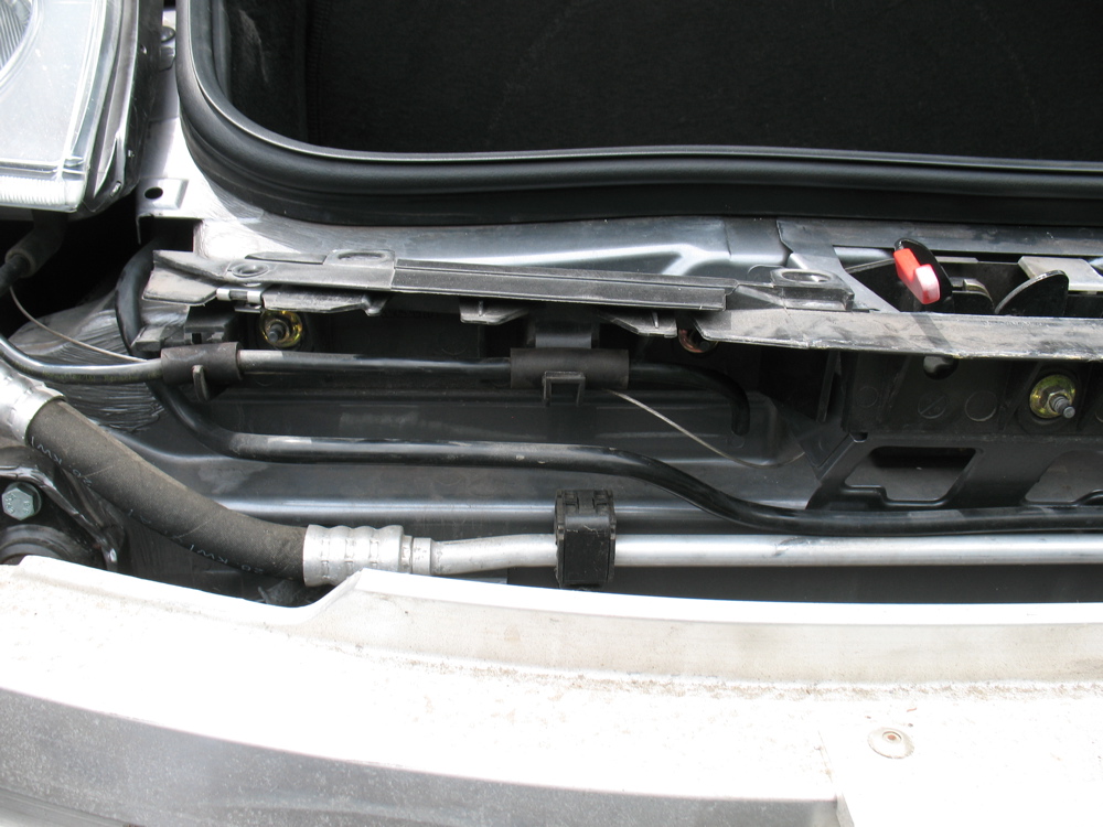

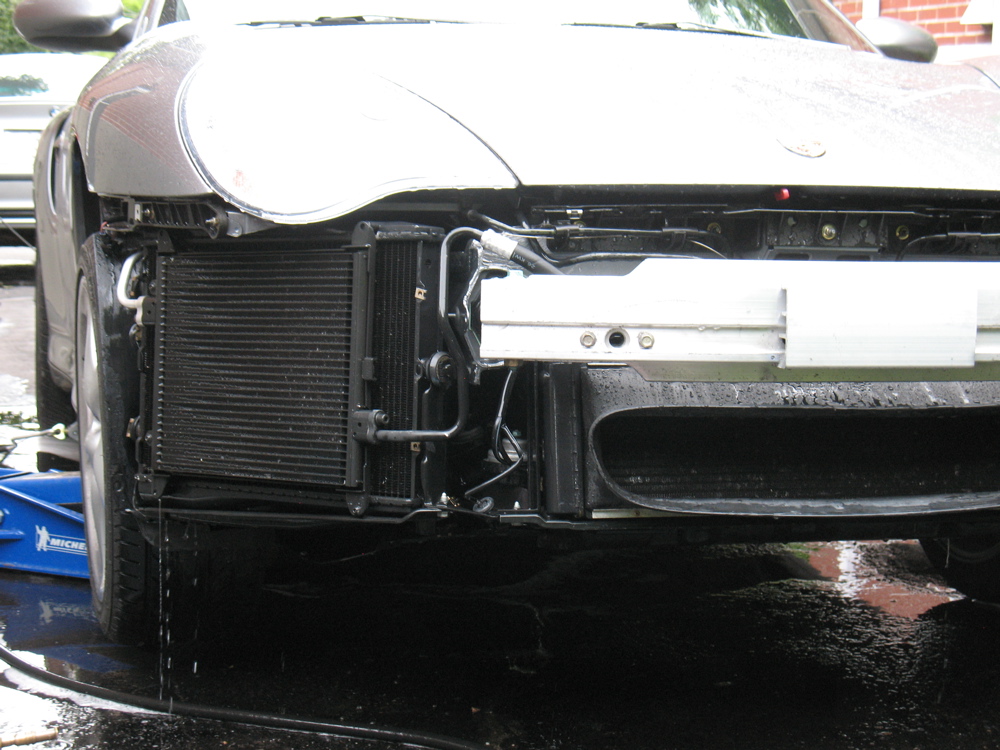

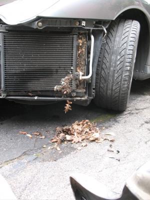

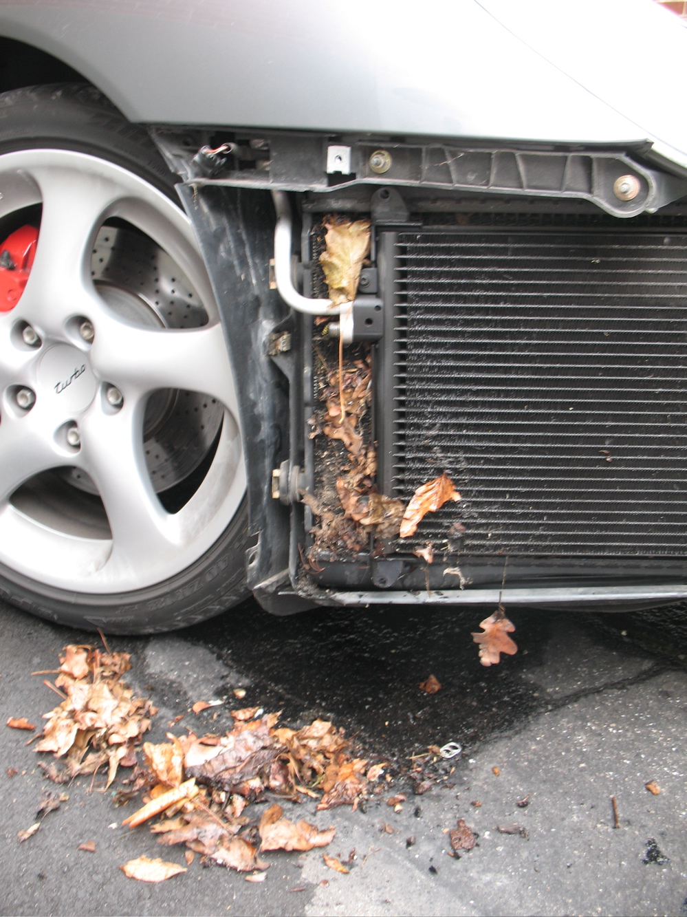

What a surprise after the front bumper removal. A lot of leafs and dirt stuck in the corner on both side blocking part of engine water cooling radiators and a/c condensers...Do yourself a favor. It takes only 30 minutes max to remove the plastic cover of the front bumper and after you got access for a good clean up and inspection... Also I was surprised to found a cable that release the front hood. But I cannot found were it goes....I dismantle the right wheel well covers but no access to this cable because I have read somewhere about an handle... I am sure it is an emergency release but does it go to the cockpit or behind the glove box. Thanks, J.P.

Your emergency release for the front trunk is behind the passenger's headlight....the one for the engine compartment is tucked behind the driver's rear tail light. Some folks (like me) move the cables to where they can be more easily accessed as suggested in a previous thread...

The only real problem with the leaf blower (which I also use to dry the car) is that it won't get rid of the dirt and debris that accumulates between the radiator and the AC evaporator.....the crud actually gets sandwiched between those two radiator like parts and you'll be totally surprised at how much can build up in between. I used to just vacuum and blow out the front radiators and thought it was a done deal.....Loren had me take off the front bumper and I was shocked at how much STUFF was in between...
You should really take off the front bumper for your mid-winter project after all the fall leaves have fallen. There are a number of pictures if you do a search showing the crud between the two. I actually had two dead sparrows on one side. Must've been mating season...they never saw it coming....so to speak.
Too bad I cannot post my pics because it is really a mess in the aft corners where everything accumulates...I am sure over 10% to 20% of efficiency was lost...

Mysterious cable going far in the aft portion of the right fender...As you mention may be it is coming back to the headlight. Will found out next radiators cleaning...Thanks for your help, info and patience with a new french speaking 996TT owner, computer illiterate. Soon my english will get better especially after I translate all Chuck Jones thread and replies to this forum ;)

Next time you clean out your radiators, re-route that "mysterious cable" from where it's lying behind the headlight to an area in the front...some guys put it on a zip tie behind the hole where the screw-in towing eye goes. That way if you ever have your front trunk get stuck shut, you can get to the cable release a lot more easily than fishing for it behind the headlight. You can actually tuck it in any number of secret places limited only by your imagination.
I learned this the hard way....and had to take out the front wheel lining just to find where they had stashed the cable behind the passenger's side headlight.
