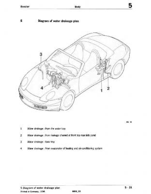

i'm quoting this from Mike Focke's site - http://mike.focke.googlepages.com/drainsdiagram :
As far as diagnosing the water leak problem, fill a quart jar with water and put a pan on the ground just forward of each rear wheel to catch the water as you pour it down each drain hole. The drains exit just forward of the rear wheels. If you have a full quart after it all drains out, your problem lies elsewhere than a clogged drain. Be sure to check each foam liner drain tray for any rips or tears, especially in the area directly beneath the V-levers that operate the pushrods of the convertible top. If you ever had one of those pushrods break and the V-lever rotated with the broken pushrod dangling, it will invariably cause a tear in the drain tray that will in turn cause water to leak into the passenger compartment.

The foam liner/drain tray is under the top. You have already tried to seal the foam liner with tape and silicon. This is a picture of them removed from the car.
Some time ago there was a mssage from someone with a similar problem. The drains under the top were clear and water flowed to the ground, but water still entered the cockpit. Maybe someone can find the message. From what I remember. The drain tube had hole in it.
The drain tubes do not go straight down to the ground. If you shove something down the drain hole, like a coat hanger, you can poke a hole in the tube.
