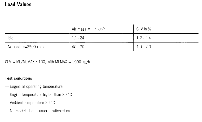

Her are the "within" ranges for air mass (the air flow past the MAF)
Idle -- 12 - 24 ML in kg/h
No load, n=2500 rpm -- 40 - 70 ML in kg/h

I'm not sure what manual you are using but the here are the values from the DME 5.2.2 Porsche manual -- and you are right on.
(click to enlarge)
