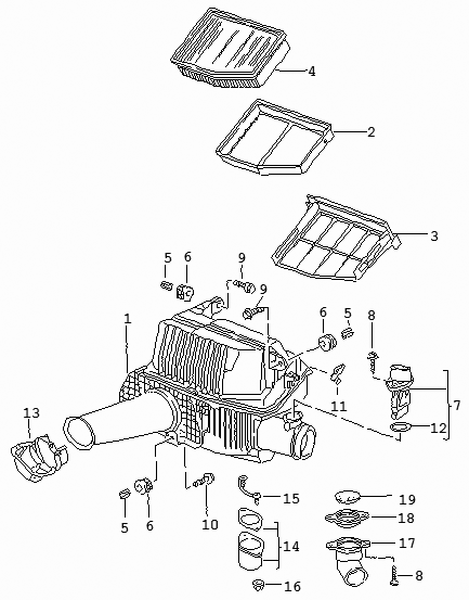

macsak, do you have a picture of your 550 air box or recall if it is similar to the normal 986 air box? Obviously, the "door" to replace the filter must be different. I'm wondering if the MAF, air-tube, etc., are the same.
I also agree with Skibum. There is no way that removing the snorkel is going to increase intake air temps. Not unless the air is cooler at the upper middle of the side intake than it is an inch lower at the middle of the side intake. Air is not being pulled from inside the engine compartment, with or without the snorkel.
To be clear, the snorkel is part 13 in the picture, not the tube leading up to part 13. My guess is that it is there to decrease noise.
Actually I removed 1 and 13.
There is still no way for engine compartment air to enter. It is sealed. (I just took mine apart again to check for sure)
I stand corrected; I removed 1 and 13 as well. It's been a while so I guess I'd forgotten. I agree that the compartment is still sealed and does not pull air from the engine compartment at all. Given the volume of air that passes through that tube, the incremental temperature rise would be minimal, even if it has a slightly higher surface temperature than the snorkel would have.
