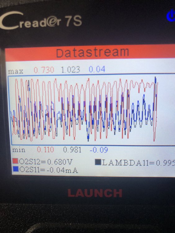

I hope I am doing this right, I definitely have fluctuation of the rear ones. This is at idle. Bank 2 looks all screwed up range wise ? The rear ones (red) show way more action. Don’t they look interchanged?

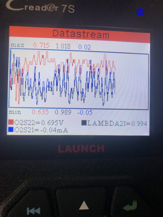

8 hours ago, rossi said:
Just realized the scanner should be in higher RPMs then just idle, I will re-test.
Bank 1 seems to look much better. This is at 2100 RPM. It looks like it is running rich right?
Refer to my first graph above; what concerns me is that you are not getting a true nearly flat line from the rear O2 sensor and a rhythmic sine wave like curve from the front sensor, yours are showing a bounce that should not be there.  You could have fouled cats.

If you look at the black line for Pre-cat sensors, it seems to be running way too high right?
It suppose to flex between 0.1 to 1, it is pretty flat at 1. It seems to be all screwed up.
The upstream sensors supposed to flex in values, downstream sensors should be nearly flat is my understanding, it like it is the opposite.
Edited by rossi
If I'm not mistaken, your precat sensors are wide band so the graph is showing +/- mA fluctuating, which is normal. The postcat sensors are narrowband so they return voltage from about 0.2 to 0.9v. If the cats are good, the postcat sensors should read about 0.7v steady at idle but yours fluctuate quite a bit.
The lambda line should be close to 1.0 at all engine speed.

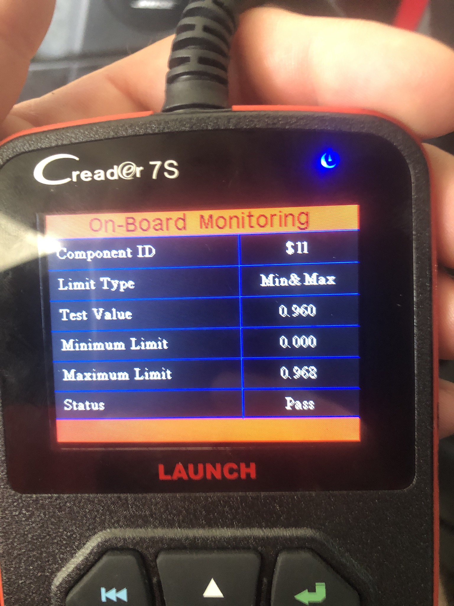

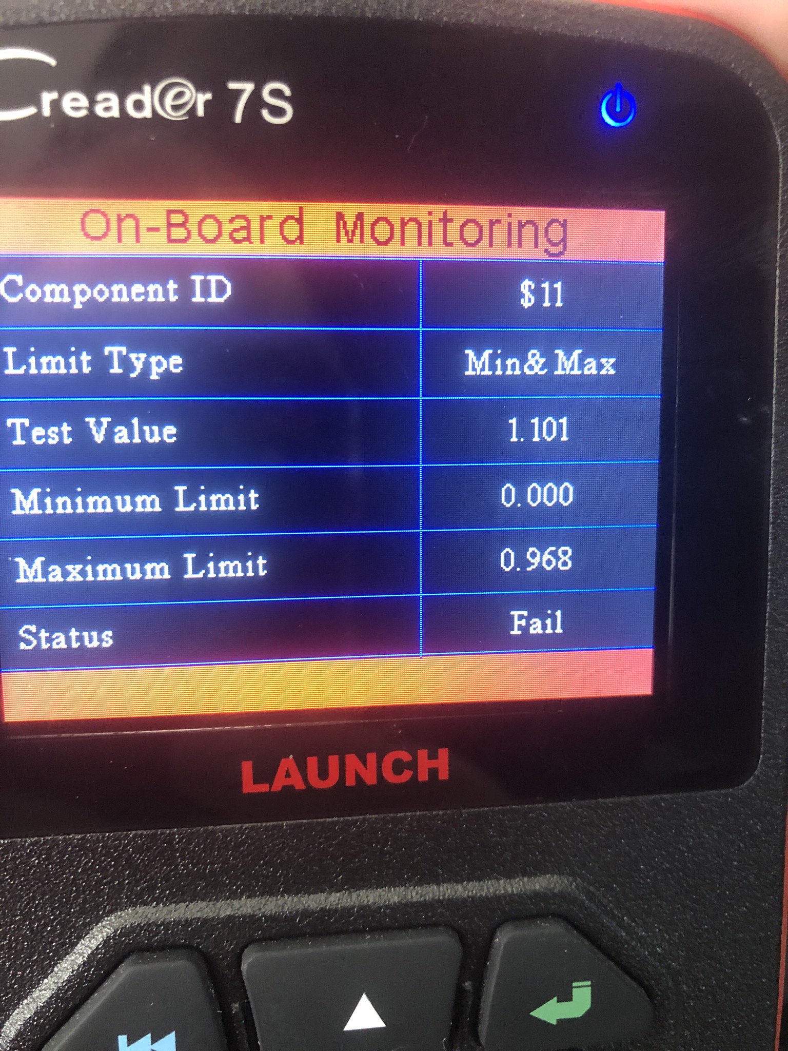

So in conclusion, it seems your cats are bad (barring any exhaust leaks).
You could use clear the codes and rum a bottle of techron or seafoam in your gas tank and see if the codes come back. Can also check the cats monitor reports to see if that makes a difference.
