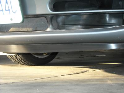

Even though I have not expierenced what is being mentioned here. I will say I notice maybe I am crazy, that the addition of a font lip spoiler which I just did, not only improved the front lightness condition, but also seems to keep the temp lower at high speed. I did notice without the lip spoiler a full tank of gas helped.
Kevin, what spoiler did you add, what suspension do you have and what is the front clearance? Thanks!!
The spoiler droped the front 2 inches, stock suspension. The spoiler used was a razzi. It was a nice mode on the 2000 C2. I also have the Aero kit II side skirts for the 2002 and up.
I liked the razzi, because it is not fiberglass and has flex to it, paints nice, and keeps me from spending a fortune on a bumper change out. The actual appearance is even better then the pics. Was really easy to install. It fits like a glove. I am now contemplating putting a lip on it to lower more.
www.razzi.com.
