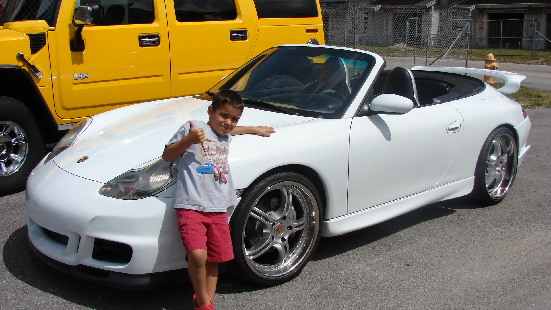

BTW... Where did you get that front bumper cover on the white 996 in the picture? I like it!
Got it on ebay brand new durafles with the lower lip under 900.00
Is it Fiberglass or polyurethane? Is the fitment good?

Thanks for the info. the bumper is polyurethane. I have to say it's like OEM fitment. only thing I had to do is buy a new set of side marker for 2005 and up since the older original ones dont work with this bumper...
