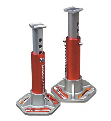

I bought the Torin Aluminum Jack Stands and really like them.
http://www.northerntool.com/webapp/wcs/sto...13386_200313386
