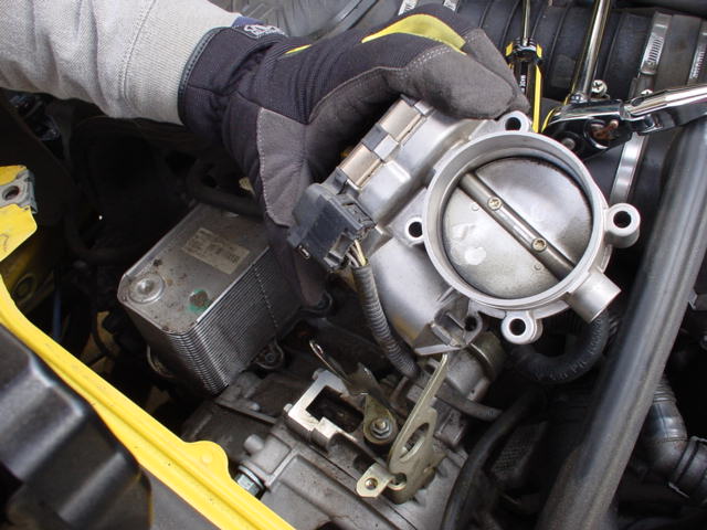

You can see the egas throttle body in the first pic in the first post.

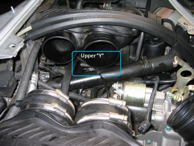

It's hard to tell from the pic, but that "looks like" the Y-Tube you will also likely need to replace. I believe the part # is 996 107 146 00. But I may be wrong.
That needs to be disconnected. See this pic:

Yes, I do see which Y tube you're talking about, I'll make sure to order one.
Does anybody know how to remove the small Y (red arrow on my picture above)?

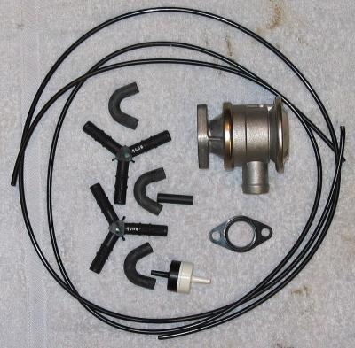

Yes, you can just pull it off. It is part off the vacuum system and connects the check valve to another of the small "Y" tubes as the bottom of the vacuum reservoir. Attached pictures shows mine removed and parts for the vacuum system rebuild and shut-off valve replacement I will be doing this weekend.

Is the Throttle body for egas shown in the first pic on the RHS the mettal looking thing in the centre right of the picture with cooling fan like things facing the camera? I want to clean mine after i replace my AOS as my engine bay looks like his
