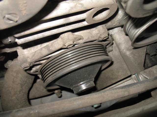

2) Check for excessive play and water leak traces, if OK the pump can, theoretical, remain. On the other hand, i have seen a lot of pumps destroyed after a 90 K service with belt change, cause the better grip and higher tension of the new belt. It's your choice.

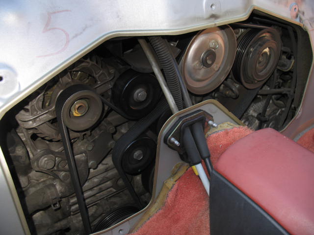

Once you get the belt off check anyting that spins. Pay attention to the pulleys and water pump. There should be no play in the water pump pulley. The bearings in these pumps don't seem to last. Bunch of waterpumps replaced in my area. Seem to go out around 70K miles. Independent mechanic I know is now using a different brand than the one Porsche sells.
Just did this today, you need a 24mm or a 15/16 wrench to hold the tensioner. I used a 15/16 socket and a 24 inch breaker bar to do it so there wasn't a lot of straining. As above, check all of the pulleys and idlers for movement or play, There was a tip on petes board to install the belt on all pulleys except the idler just to the right of the alternator, then move the tensioner and slip it on, worked like a charm for me.

Water pump pulley has some play and getting a sound from it, mechanic told me is the bearing on the water pump and I will need to replace it. Do I also need to replace the pulley or would it be fine with the new water pump?
The bearing is likely gone - so replace the pump before more damage is done.
