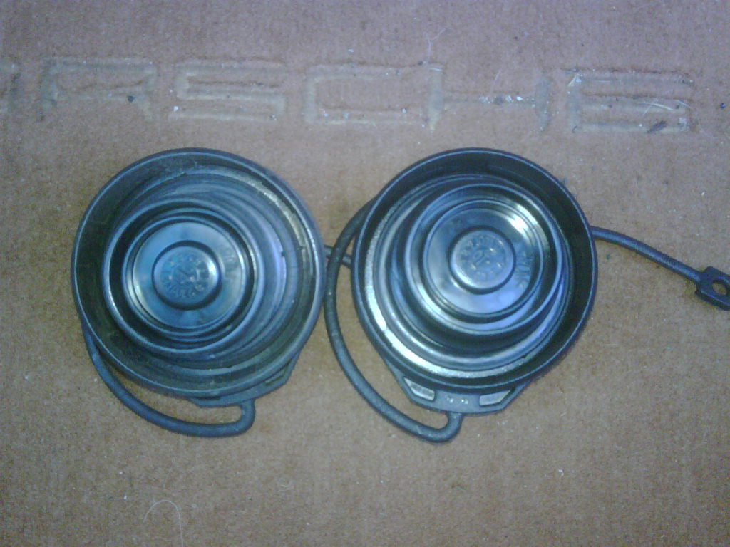

Loren - thanks for this.
You don't happen to have a part number handy and a place I can buy a replacement gas tank cap do you?
Thanks!

US car?
If so, use 996.201.241.03 Fuel tank cap w/ clip -- US MSRP $13.07
or
go all out with the optional aluminum look cap 997.201.980.00 -- US MSRP $163.39

Wait I think i found it.
The car is an 02. maybe I will just replace this as a preventative
http://www.bestsourceautoparts.com/partsCa...ageFrom/catalog
