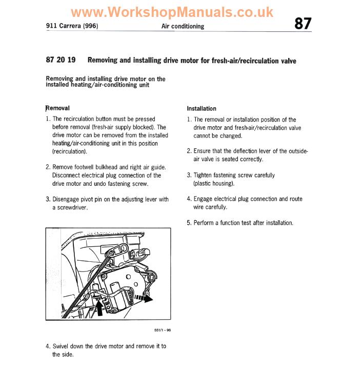

Written in manual it should be removed with the recirculation button pressed but I do not get it working...

As you can see on attachment the motor has two (2) linkage arms. One goes to a flap visible at right footwell at the bottom (open is air recirculation) and the other one is a flap just below your cabin particle filter underneath the hood.
What I did to solve my problem temporary is manualy forced the motor and flaps to fresh air position (flap under footwell CLOSED) and disconnected the electrical cable to the valve.

The bolt is an 6mm (metric) size but be aware it is a real PITA to reach from bottom and once the motor is out it is even worse to get it back!
To get some better acces remove the rightside bulkhead (under carpet) side vent airback and air ducting.
See attachment from the workshop manual on how to remove this. Goodluck and let me know the outcome!

Not according to the instructions in the service manual...
