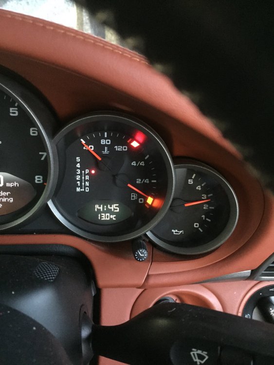

It is related to the issue with my coolant temperature gauge throwing an error intermittently. I have had the coolant temperature sensor replaced, and coolant system purged and new coolant put throughout.

I attempt to clear them using the durametric software, and the coolant temperature gauge returns to 80 (middle) and the fault exclamation light goes out. However the P1654 remains.
Now, this is the strange thing, and may give the best information yet as to what the fault might be: if I leave the car idling the gauge stays at 80 indefinitely. However, when I drive off, after a few miles it will fail again, and give the two errors above.
My best idea is that it is something to do with a short somewhere that only becomes an issue at low temperatures, or when low temperature air is operating around a certain area of the car's engine. Once failure has occurred, if I leave the car idling and stationary for 3-4 minutes, it will correct itself and the fault P3081 disappears. Maybe this is because the warm engine is heating up the part of the car that contains the short or whatever, that would otherwise not get warmed up if there was airflow over and under the vehicle. Also, in summer it is never an issue....

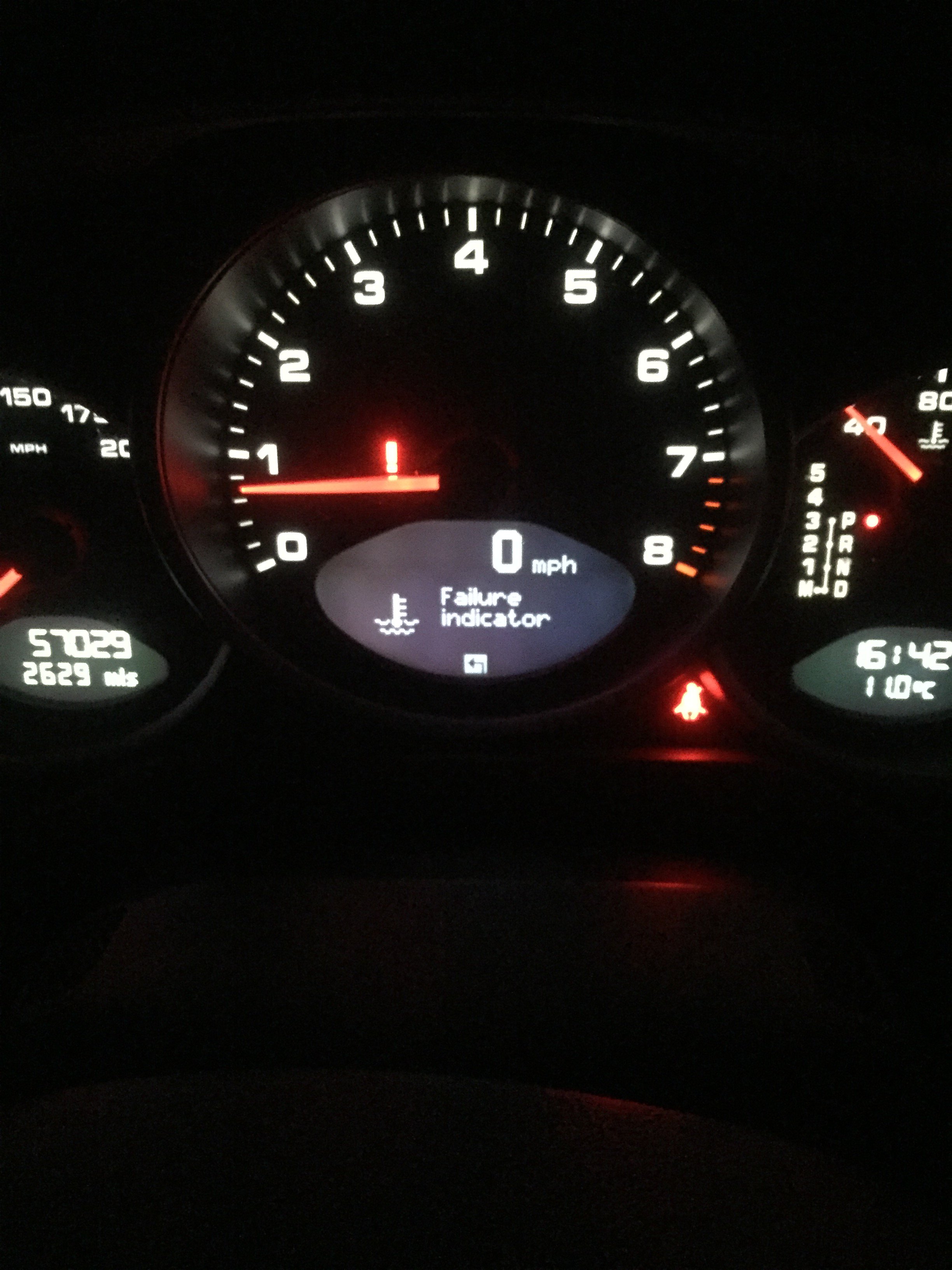

Just to add. The car is 2007 997.1 3.6 Tip. & has just had new coolant pipes, front to back. New LTT fitted. Also PSE removed & Aftermarket sports back boxes fitted. Engine out & new RMS.
the work was done prior to the problem. But the system has been drained & refilled using vacuum by another Indy closer to home to avoid driving distance. Alert on dash says (picture of thermometer) failure indicator.
