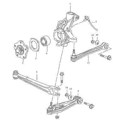

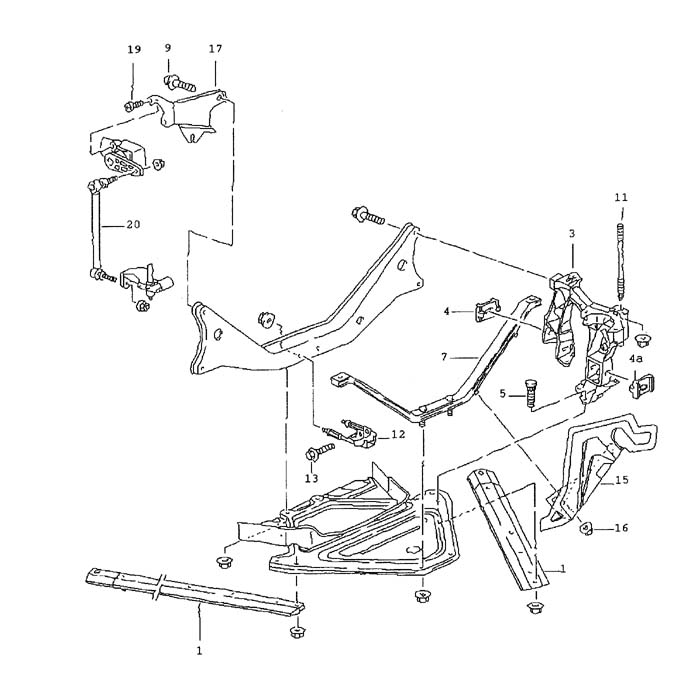

Refering to the attached drawings:
Are you saying that when you press down on the wheel carrier that forward suspension link (8 in the first drawing) is hitting the diagonal strut (1 in the second drawing)?
That is odd. On my car (though it does not have the stock suspension) at full droop there is 3 inches of clearance between the forward suspension link and the diagonal strut.
If you can, take a picture of what it looks like and post it or send it to me.
