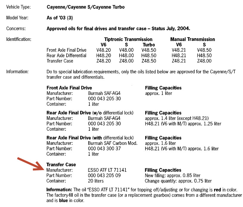

Loren sent me a sheet which listed all type of oils that used in the Cayenne '04. In there, it lists ATF as the oil for the Transfer Case (sounds a bit strange).

Many sites referred transfer case oil is the same as ATF oil. But in the spec sheet Loren posted indicated different part number for the Transfer case & ATF (ex: Transfer case: 000 043 205 09 or (LT71141) --- on the ATF bottle I bought: 000 043 205 30).

So for everyone that has been discussing Porsche Cayenne ATF....AKA JW3309/LT41171.
Porsche PN 000 043 205 28

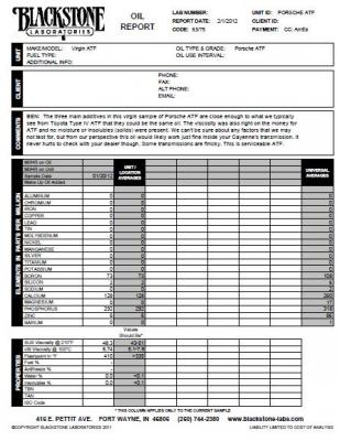

There has always been debate on Toyota Type IV being the same as the Cayenne ATF. So i sent in VIRGIN SAMPLES to blackstone to get the analysis on additives.
The results are shown below:
..........................................Cayenne ATF....................Toyota Type IV
Boron.......................................73.........................................84
Calcium...................................128.......................................105
Phosphorous...........................292.......................................271
Zinc...........................................6..........................................11
SUS Viscosity @ 210F.............48.3......................................50.1
cSt Viscosity @ 100C..............6.74......................................7.26
FlashPoint in F........................410.......................................370
Translation.....Both fluids are chemically the same as far as blackstone can see with their equipment. I attached the Porsche ATF slip for reference. VOAs cost $$, but well worth it if it saves cash down the road. I have some diff fluids coming as well for a VOA as well. The flash point requirement is >335C, which both exceed.
So save yourself some $$ and buy the ATF from Toyota. 6 bucks at the yota dealer....as apposed to 60+ as the porsche dealer?

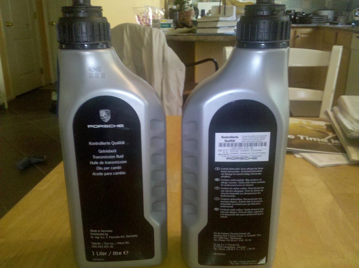

I'm attaching a pic of the fluid I put in my transfer case. The part number does not match any number that I've read. Mine is 000 043 205 30 (the last 2 digits don't seem to match!)
Can anyone confirm that this is THE RIGHT oil for the transfer case. I haven't driven the car since I put this new liquid in.
Thanks
post-55939-0-28049400-1342129022_thumb.j
Thanks
That is gear oil that is used in the front and rear differentials -- not for the transfer case.

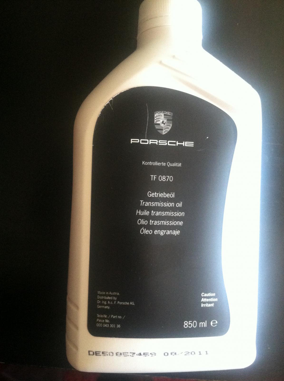

I purchased the OEM differential oils for the front and rear end and through ecs tuning I was directed to OEM part#00004330136 ATF for the transfer case TF 0870. This is a different fluid and spec than the 00004320509 listed above. Is this a revised spc for the transfer case or was I provided with the wrong fluid?
Edited by Francin728
That is it. The latest part number for transfer case fluid is 000 043 301 36.

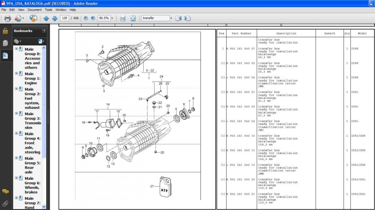

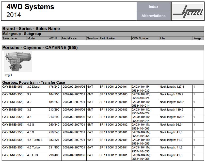

The transfer case in all AT 955 and 957's S, GTS, Turbo and Turbo S (both 4.5 and 4.8) is #95534104055.

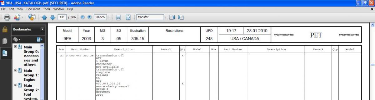

If you search porsche's parts catalog you will find that the ATF fluid is listed at pos.27 as part# 000 043 300 36. That part, however has changed to 000 043 301 36.
Same for the two plugs, listed at pos. 20 as part# 955 301 115 00, have since changed to 955 301 115 01.
