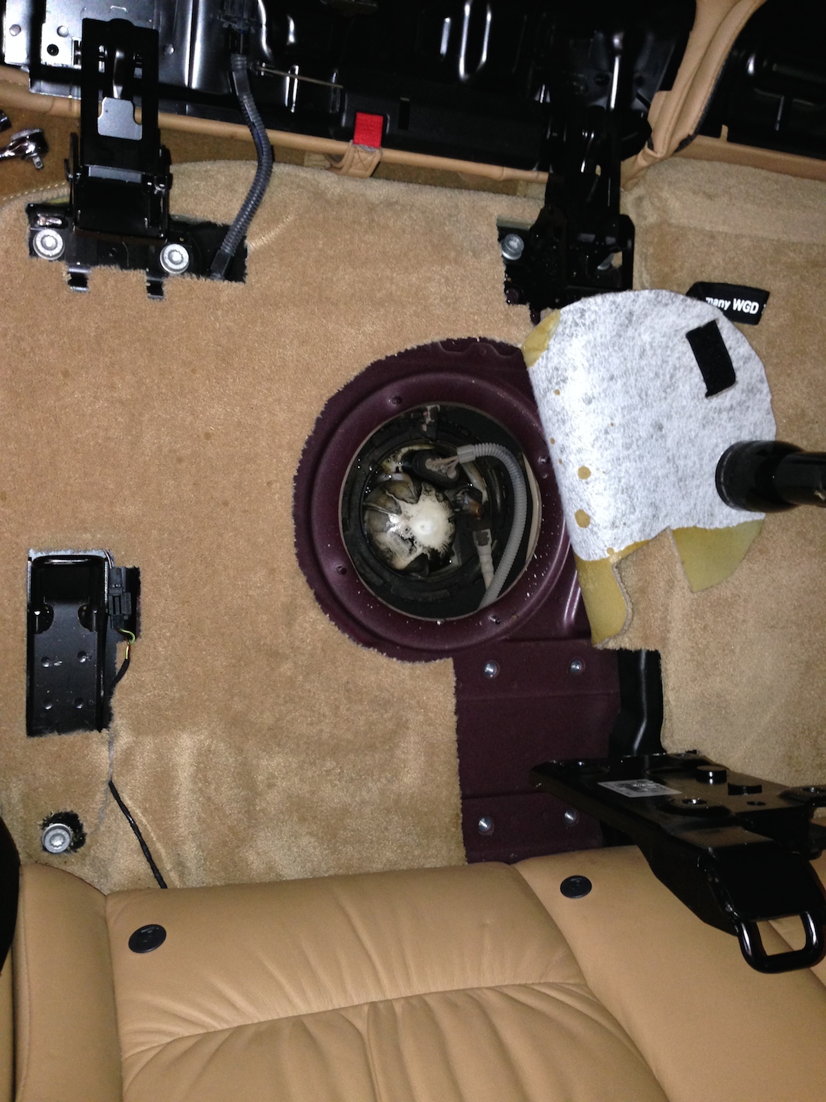

I would check for a leak in the left fuel pump connection area, tilt the rear seat, under a pre cut spot in the insulator you find a round metal cover, remove the cover and you have full access to the pump connectors.
RFM is right on the money. The most common cause for this is a leaking drivers side fuel tank flange. Should be part # 955 620 841 00. Due to the design of the tank, both flanges must be removed( there is one on each side of the tank) so you'll also want two sealing rings ( 955 201 133 01) There is an updated pipe that porsche wants you to install on the drivers side flange as well, 955 620 911 001.

Here is what I found. It's not the seal that typically goes bad....but the crap the may have gotten under the seal during assembly or over time....I cleaned the flange on the left tank hole during my pump replacement and reused the old gasket.....This is as compression gasket so as long as the surfaces are clean and not bent the gasket will still seal nicely. ...like with many other things....The preparation work makes all the difference.

These forums are awesome.  The information brought me directly to the source of my gas smell.
I found my leak to be a tiny point at the top of the fuel filter assembly which would push fuel out very slowly when under pressure.
