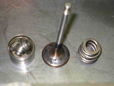

I few weeks ago, I was driving on the highway and the check engine light came on followed by power loss. I pulled over right away and turned the engine off. I then had it towed to a Porsche dealer. They took the transmissions out and told me there was no RMS or IMS problem. Then they did a leak down test and found leakage. Then they took the engine out and took the heads off and saw that a valve was bent. This was due to broken valve spring.
At first they thought I had missed a shift but the computer showed that there was a range 1 over rev. 50 hours ago. I believe this happened when I was on a DE day. I was told to keep it in 3rd gear for the first few laps and I hit the rev. limiter once or twice going about 100mph.

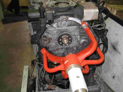

  • post-58143-038869900 1285122710_thumb.jppost-58143-000624300 1285122694_thumb.jppost-58143-024363100 1285122654_thumb.jp
  • post-58143-011229200 1285122674_thumb.jp

I feel your pain. I suffered a broken valve spring a few years back. A simple bore scope inspection revealed a shiny smile on the top of one piston. A compression test confirmed zero on that cylinder with the others being fine. I exchanged PM's with another person here who went the repair route vs. replace. You could do a search and probably find the postings concerning this same issue. If he is still on the board, he may be able to give you some ideas on cost. If I were you, I would replace all of the springs on both heads at a minimum.
BTW, my valve spring failure was not the result of an overrev....car was a Tip
If it did not damage the head or the piston you might just be able to do a complete valve job (new valves, springs, guides, seals, etc.) on that head. In the picture of the block I don't see the chain from the IMS to the cam/head. Was this removed? I see the guide rails for it.

Yes, the cam chains have been removed and are not in the pic.

How did they get the chains off without splitting the cases?

I saw the chains at the bottom of the case. They had a white paint mark on them. I asked him about it and he said it was to mark the position. I'm guessing he must of slipped the cam shafts off .
post-58143-082220200 1286023919_thumb.jpHi,
The work on my is progressing. Although slower than I would like. But the dealership is in the mist of expanding so I am being patient. He has done about half the work. He has spent about 20 hours so far. So I expect another 20 or so to finish the job. I was there for an update and took a picture of one side of the block after it was de-coked.
