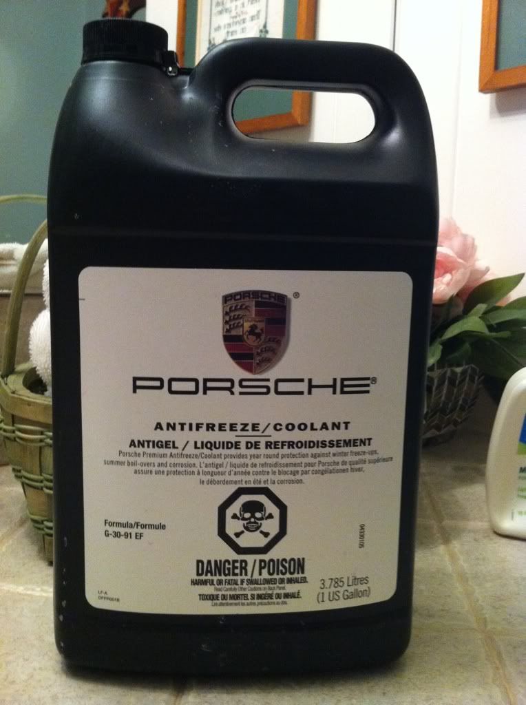

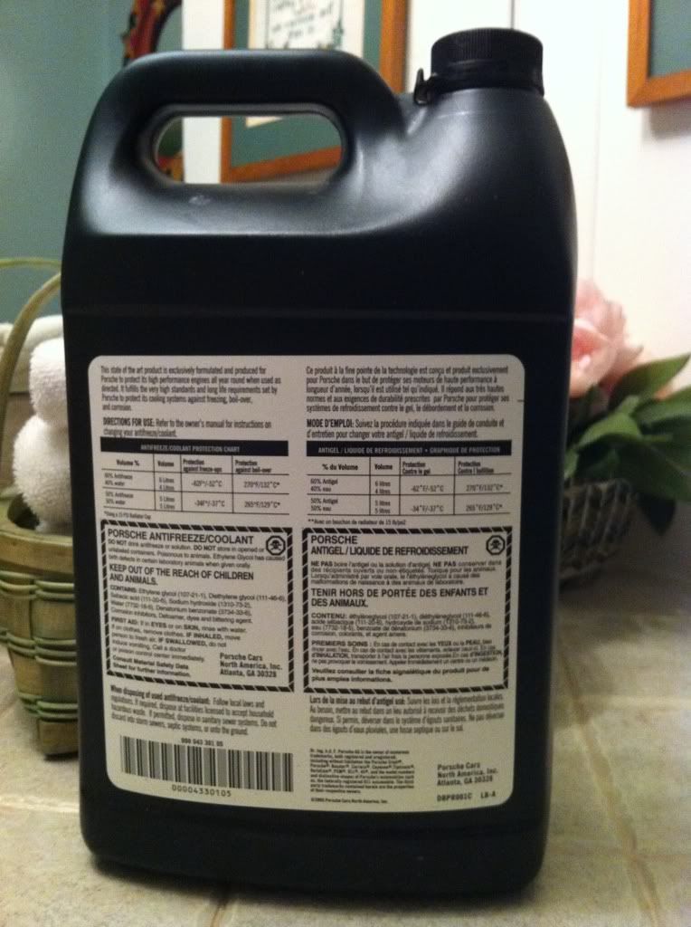

I recently added a third radiator, 150 dgree thermostat and a new waterpump to my 98 Boxster. I replaced the old coolant with original Porsche Antifreeze from Sunset. It was reddish pink when mixed. The old fluid was yellow. Both are ok.
The part number is:
000-043-301-05
The cost was $21.07/gallon at Sunset Poesche
a 50/50 mixture with distilled water provides protection to -34F or -37C
