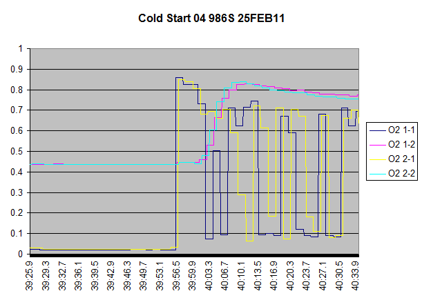

Secondary air injection exists exclusively to raise your catalytic converter temperature as quickly as possible to reduce emissions. When the cats and O2 sensors are up to the proper temperature, it turns off. You will get a CEL if it fails, but it's not going to impact the drivability of the car if it fails. Shoot, it it wasn't for the CEL, I'd have removed mine just to drop the dead weight.
Boxsters don't directly measure much of the secondary air injection system; health is determined indirectly by O2 sensor data, which is accessible through OBDII. I've attached a plot of O2 sensor data starting my engine (3.2L) cold on a moderate day if anyone needs to compare with your readings.
post-24850-0-15760900-1325960360_thumb.p
