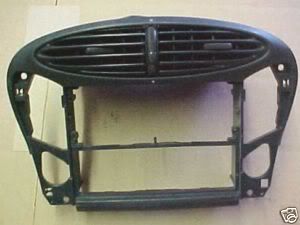

Or buy the PCM double-din bracket. Probably 996.552.231.12 or something like that. Appears to be available for about $55.
I would like to go the other way. I have the stock CDR220 and the cup holders in my car. I picked up the horseshoe trim in dark wood but it is a double DIN unit. I would like to convert it to the single DIM configuration. Does Porsche have a piece for this? I should add that this is for a 2000.
Edited by Dharn55
Are you asking about the trim piece or the internal support frame? In any case, yes, there are part numbers for every one of those pieces. See Illustration 809-02 in the parts catalog "Dashboard lining with retaining frame". The support frames are as above, 996.552.231.xx, where xx = 11 for standard, 13 for M662 option, and 12 for M665 option. The switch trim is 996.552.967.xx, with a bunch of options for color/material.
