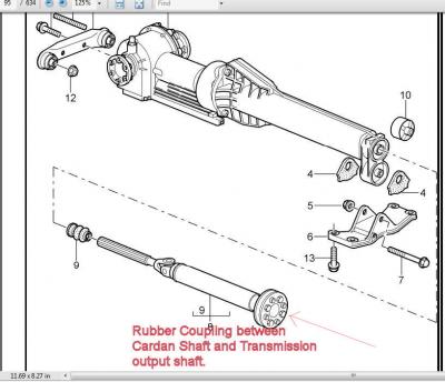

2002 C4S. Dropped transmission to replace AOS and Clutch. When disconnecting the cardan shaft from the transmission I found the rubber coupling to be cracked in a number of places. When I call the Porsche dealer they could not locate a P/N for just the rubber coupling. I am told it comes as a part of the entire shaft assy at a price of approx $450.00 When I look at the PET parts listing I can find no break down of the part either. The rubber coupling simply bolts to each part with 3 bolts each direction.... No reason I can fathom as to why the part is not listed separately as a wear item. Was hoping someone on here has been down this path before. Search revealed no clues...

post-44649-0-61219900-1297466116_thumb.j
Ouch! Thanks, looks like I have no other alternatives!

I have 95K on the car. I had no indications but noticed it when I dropped the trans to replace the AOS and Clutch. Primary reason was the AOS going bad and decided to replace the clutch while I had everything out. Coupling was cracked in several places, one area had a crack on both sides that almost came together in the middle. Ordered the entire shaft as I can find no other options. I think the entire shaft is considered a consumable item as the U-joint on the opposite end is staked in vs help in with a C-clip.

My 997 4S Tiptronic 2006 rubber coupling developed minor cracks at 28000 miles. Have a VF Supercharger fitted and drive quite hard and fast. Will monitor and check propogation. Do not think it could be catastrophic at this stage. Ridiculous to buy assembly instead of just coupling rubber.
  • FVD Online Shop - - FVD,Porsche
    www.fvd.de/.../Porsche.../997-17...4.../MoreNewestOnlineItems....ht...
    You +1'd this publicly. UndoArticulated piece cardan shaft 996 C4/4S/TT 99-05, 997-1 C4/4S 05-08, 997TT 07-,99642101000, 996 421 010 00. 57 €. Add to cart. You need not to buy the complete cardan shaft anymore. From now we offer also only the hardy disc for this ...
http://www.koperform...-Flex-Disc.html
2002 Porsche Carrera, C/4 (996) >> Drive Shafts, Axles, Differentials > Driveshaft Flex Disc
