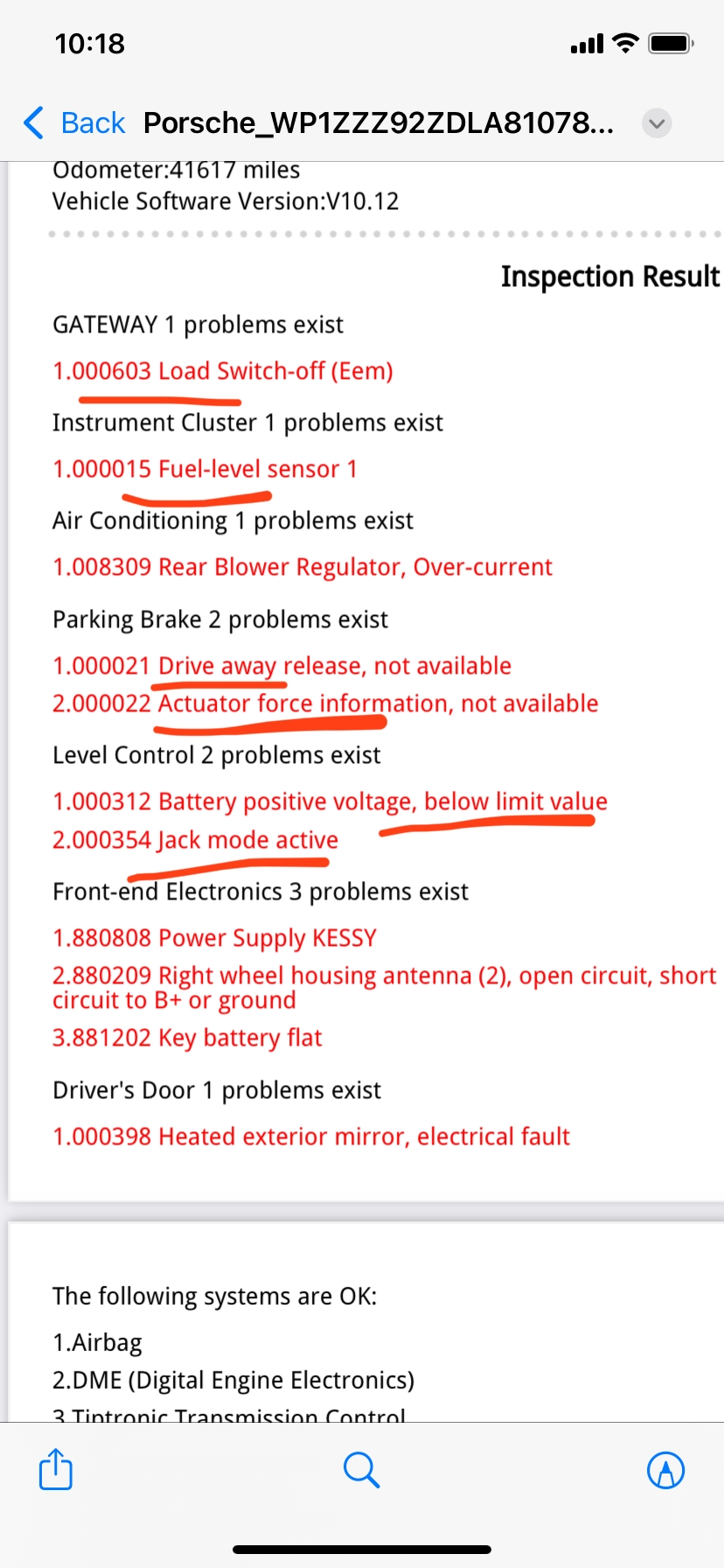

I got a 2013 Cayenne 92A recently and realized entry & drive system is not working. I see an error which tells "Key not recognized." Since I did not use it as a technology I don't have any problems with unlocking from the original key but when I digged in I found it fixable, thanks to you.
So, is anyone have any idea where I should start? Does my KESSY same with the first gen Cayennes?
I have system report that says:
- 1.880808 Power Supply KESSY
- 2.880209 Right wheel housing antenna open circuit, short circuit to B+ or ground
I'm asking because my dummy key works and everybody have different issues like weak antennas or etc.
Thank you in advance 🍾

Try clearing your fault codes and see what comes back after a test drive.
