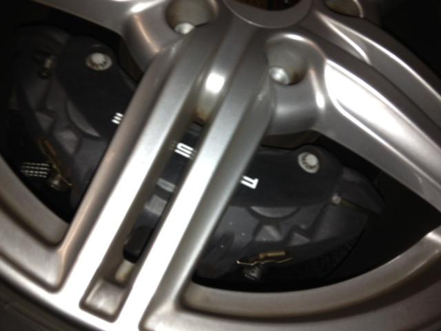

Has anyone done this yet on a 2011+? The calipers are significantly different from the typical Porsche Brembo calipers in that they don't have the single retaining pin on the top of the caliper - and the pads can't be removed from the top of the caliper. I'm not sure of the function of the 2 torx bolts facing outwards, but it appears to me that you can't replace the pads without removing the calipers . . .

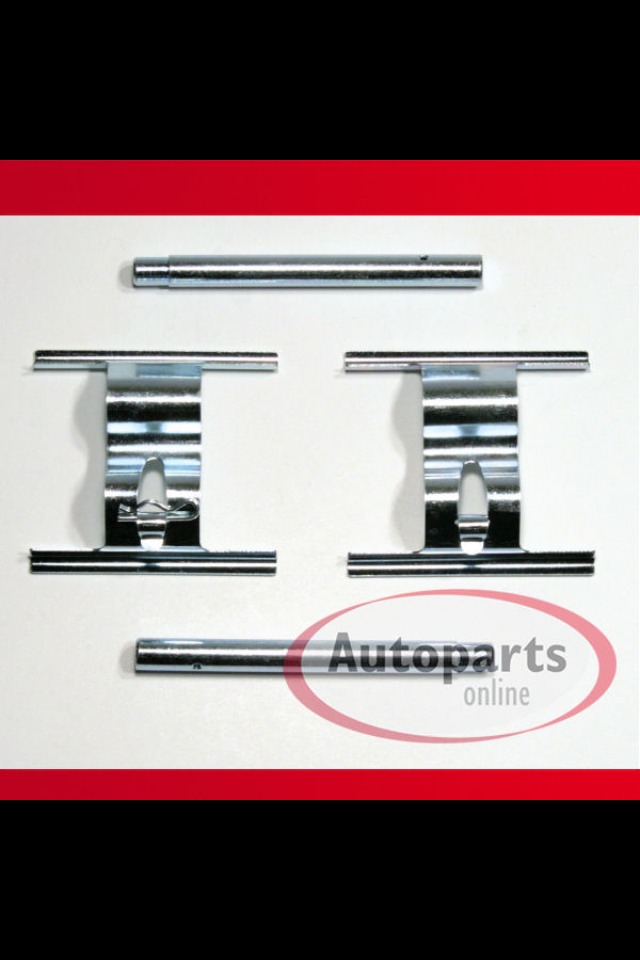

Could somebody please tell me if these parts are neccessary to change too when doing the brake pad change?Thank youpost-77547-135889894402_thumb.jpg
Share this post
No problem if the parts are in good condition and cleaned up, but replacing with new elements makes everything much easier and nicer, more proffesional work.

I would like to know too. The calipers and all look different than the older Cayenne with the central pin. I am guessing 12 point bits are required (torx it seems will not work). Caliper needs to come off?

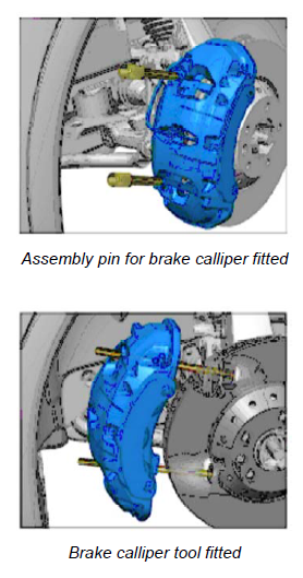

The caliper bolts get loosened then the caliper slides on two steel rods (pins) (special tool T10439) to suspend the caliper while you remove and replace the pads.

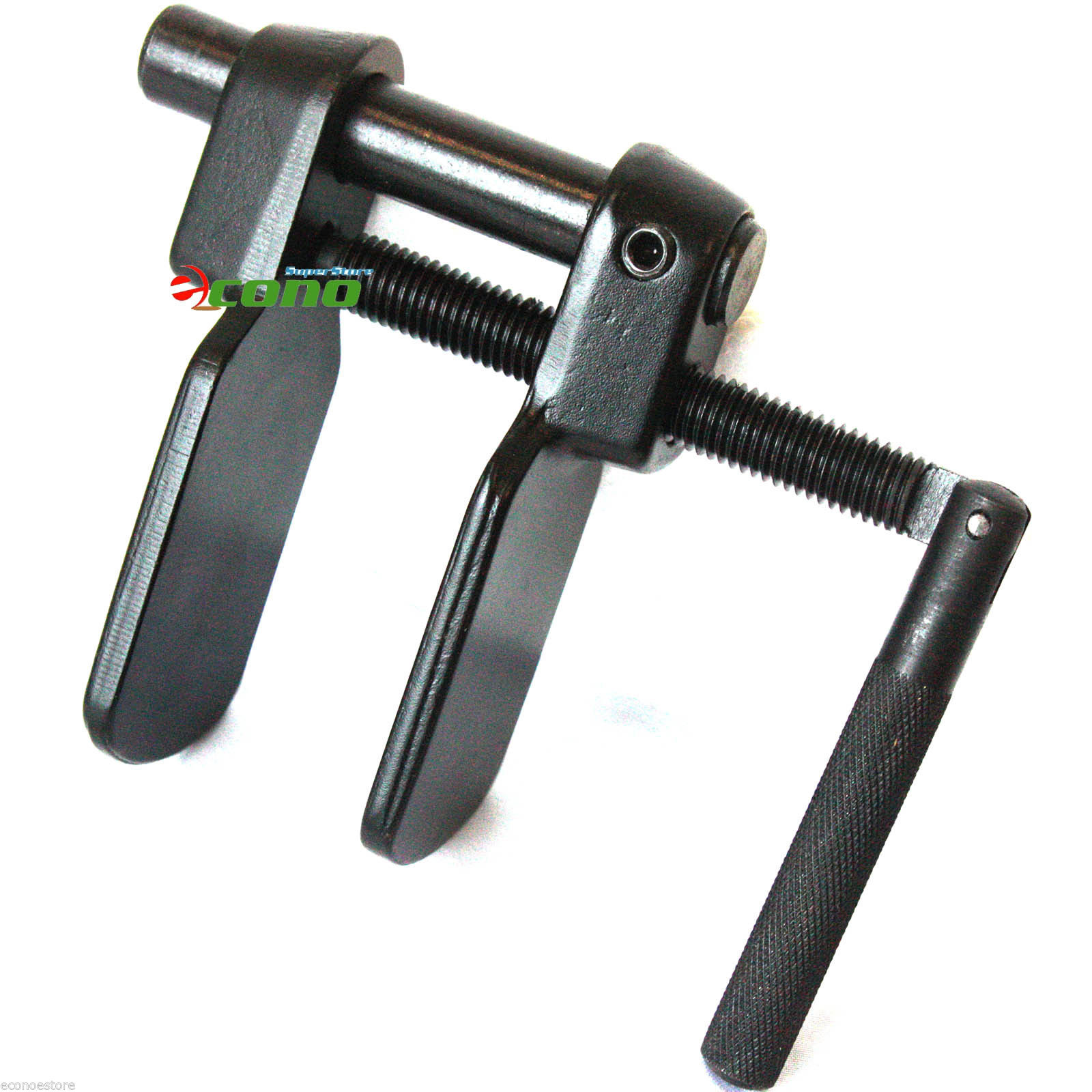

If memory serves, there was a detailed write up on the procedure's on Rennlist some time back.  Once the calipers are up on those pins, you use an angled brake pad spreader to push the pistons back and remove the pads:
Loren , so for the new style rotors on 2011-2014 Cayenne models do you just loosen the caliper bolt screws and just pull off onto pins? I was able to purchase the pins via snapon VW. I'm curious if I need to try to push brake pistons back some with screw driver to loosen pads before removing brake caliper?
Normally, if you remove the caliper bolt and install the service pins, a quick "shake" back and forth is enough to push the pads back enough.  If not, simply slide a thin tool like a scraper between the pad and rotor to push them back enough to remove the caliper.
