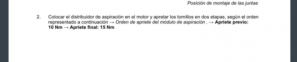

do you happen to know what the torque settings are for the intake manifold bolts? I am getting ready to replace my starter (since I was an idiot and didn't do it with the coolant pipe replacement) but can only locate a note from someone who said it was 17ft-lbish.
