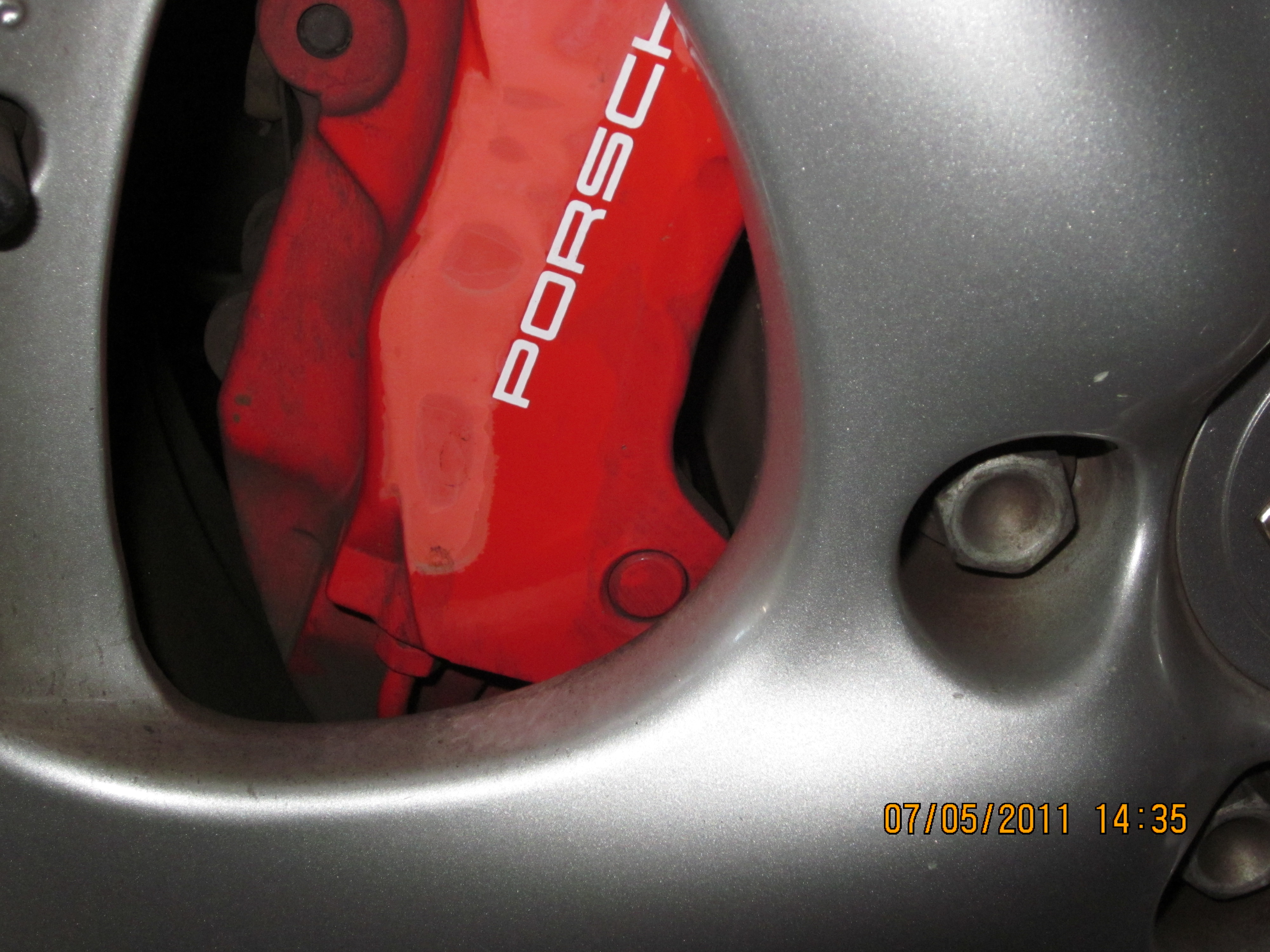

Pics are coming, thanks to all... jl

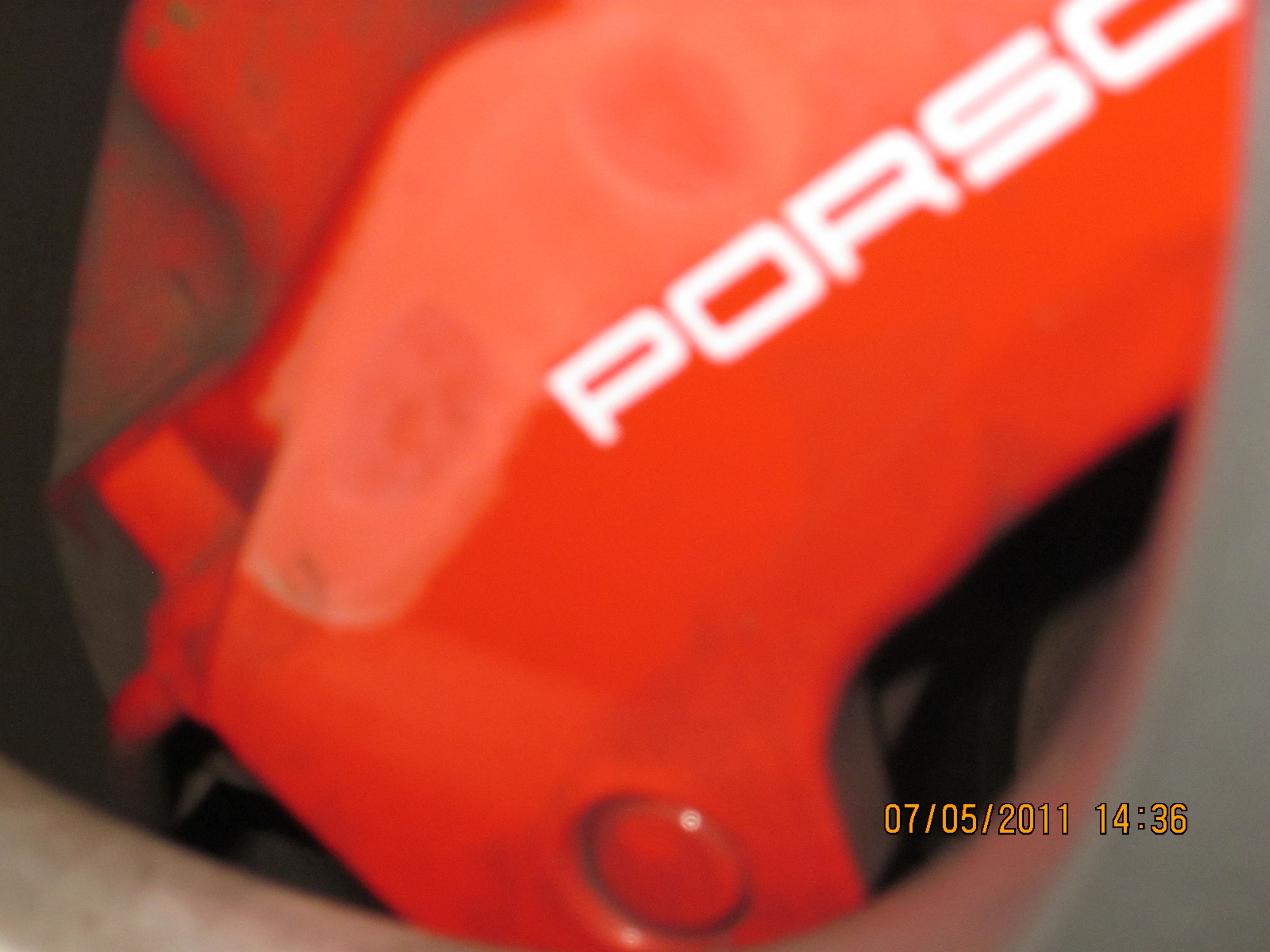

here's another... both of right caliper

What you have here is the classic "Caliper Clear coat Delamination" that is a chronic Brembo Porsche Caliper problem. Over time the clear coat gets dry, and flakes off. I have had this even happen with new calipers that was so bad, that I got Porsche to make a warranty replacement of the caliper.
I have found that the easiest repair is to feather sand off the clear coat around with blemish with 1600 grit sandpaper and respray the affected area with high-temp engine clear paint. This repair has worked for me.
thanks much. must have been brought on by the weather and sticky crap in the draining water. Never noticed any discoloration until last Saturday.
Ps: I've admired that Orient Red car for some time..... still looks great.
Cheers, jl
Common problem. You could sand through the clear, and re-clear them. Depending upon how many miles are on the calipers, and how the car's been used, you might consider rebuilding the calipers, at which point you can have the calipers powder coated.
